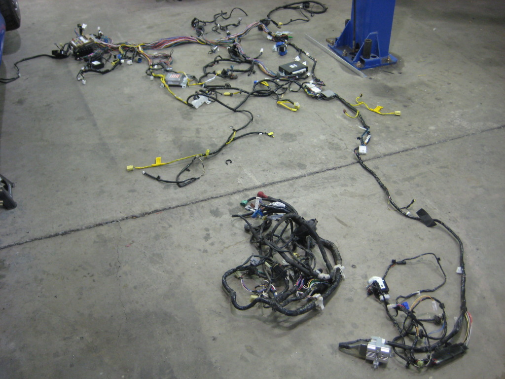

Started on the wiring harness tonight. Here is the unmolested 2007 WRX harness ready to be "reduced" wire by wire...
(IMG:http://www.914world.com/bbs2/uploads_offsite/i180.photobucket.com-11979-1283416430.1.jpg)
