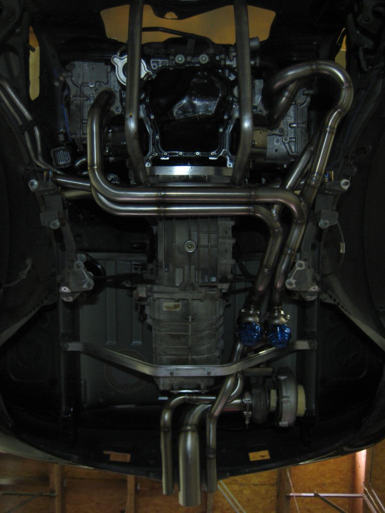

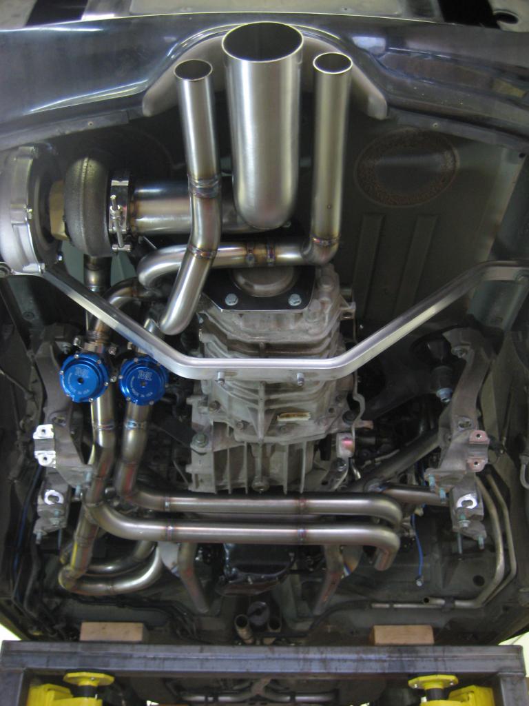

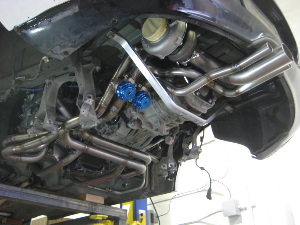

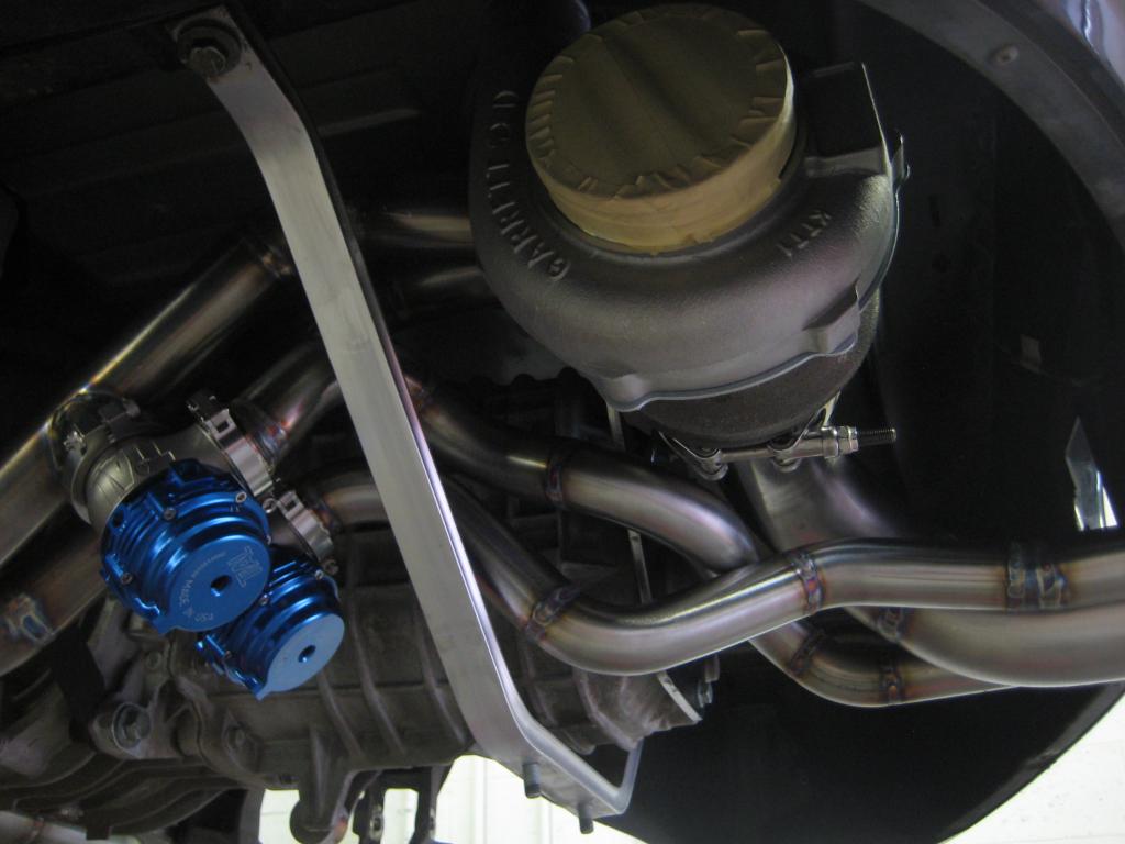

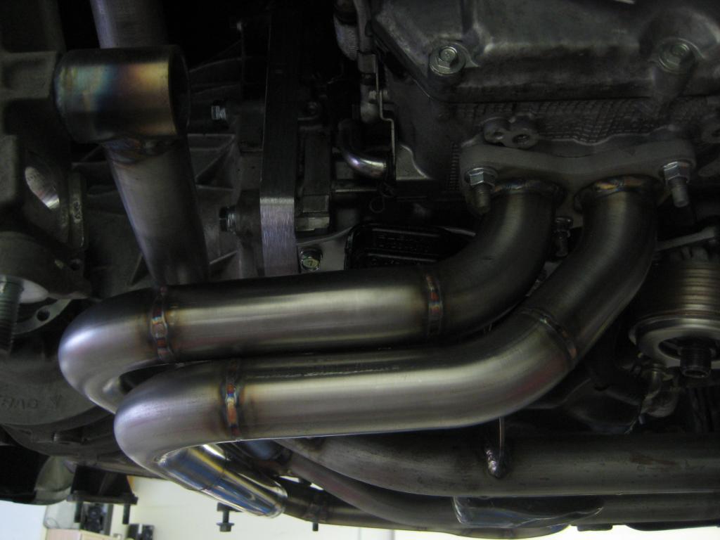

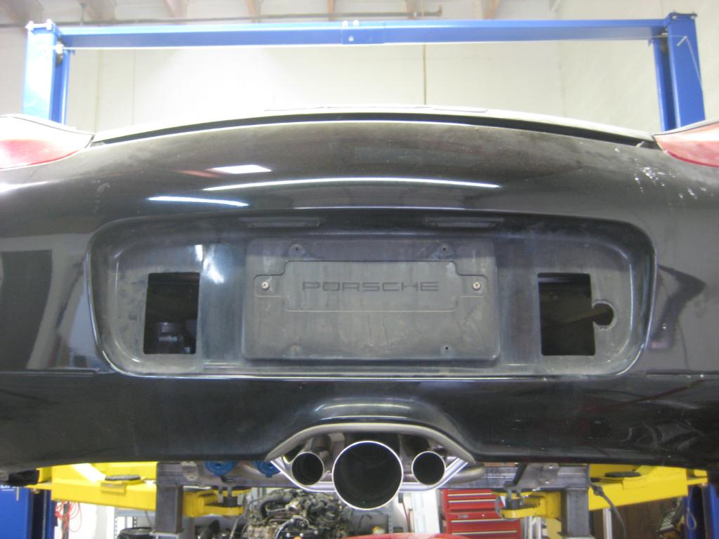

I finally got the exhaust finished today. I'm pretty happy with the way it came out. I still need to add two double slip joints in between the cylinder banks, some wastegate dump supports, and a couple of O2 bungs, but other than that, it's done. This first system is only 304 SS but I made sure to carefully purge everything, and all of the welds are full penetration welds rather than the standard "automotive style" welds so it will have the best possible chance of surviving. Also, the turbo is supported by a 1/4" thick plate bracket so the actual exhaust tubing isn't holding any weight other than it's own. If the 304 doesn't survive, then I will do the second set in 321 and see how long that lasts.

Seeing that exhaust in front would blow a Porsche snobs mind!

Rotary'14   :blink: :drooley: :drooley: That's a work ...   Sep 3 2010, 08:03 PM
charliew   The welds look good. Do you think the long tubes w...   Sep 3 2010, 09:23 PM
precisionchassis   The welds look good. Do you think the long tubes ...   Sep 4 2010, 09:37 AM
ottox914   The welds look good. Do you think the long tubes ...   Sep 5 2010, 06:58 AM

Britain Smith   That looks fantasic. Where did you get the flange...   Sep 3 2010, 11:23 PM
precisionchassis   That looks fantasic. Where did you get the flang...   Sep 4 2010, 09:40 AM
