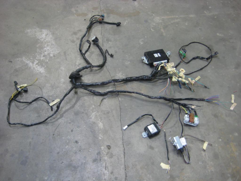

precisionchassis
post Sep 9 2010, 05:37 PM
Posts: 99
Joined: 26-July 10
From: Gilbert, AZ
Member No.: 11,979
The wiring harness has been reduced to only what is needed to make the engine run.... hopefully.
(IMG:http://www.914world.com/bbs2/uploads_offsite/i180.photobucket.com-11979-1284075463.1.jpg)

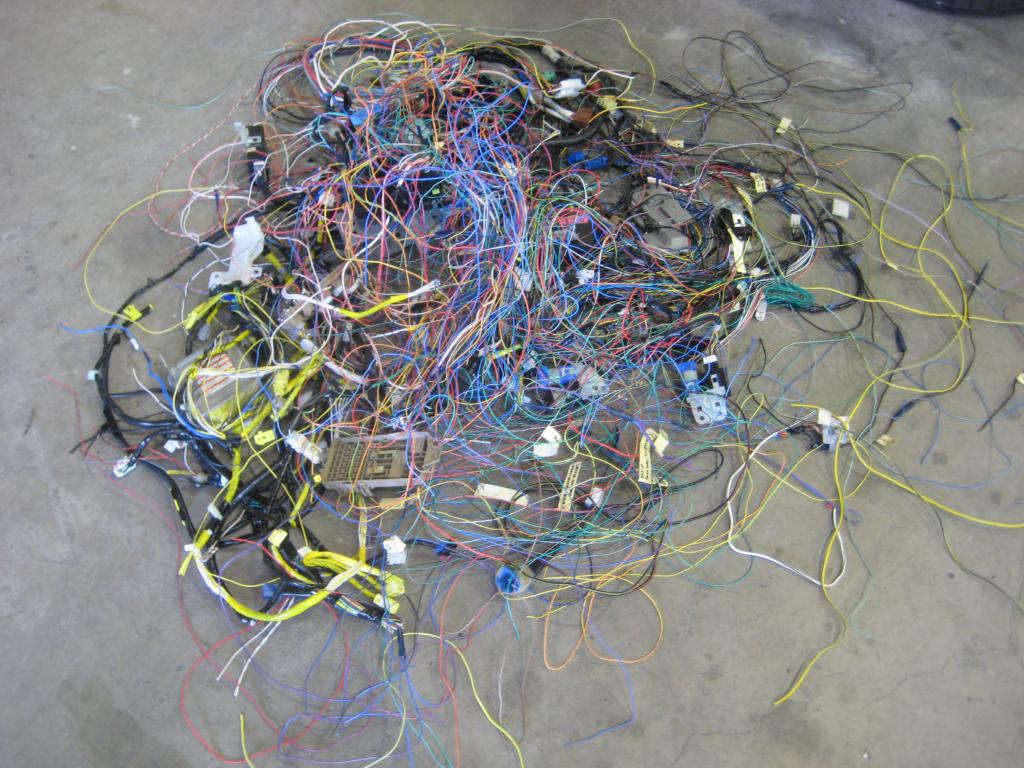

And here's what wasn't used...
(IMG:http://www.914world.com/bbs2/uploads_offsite/i180.photobucket.com-11979-1284075464.2.jpg)
