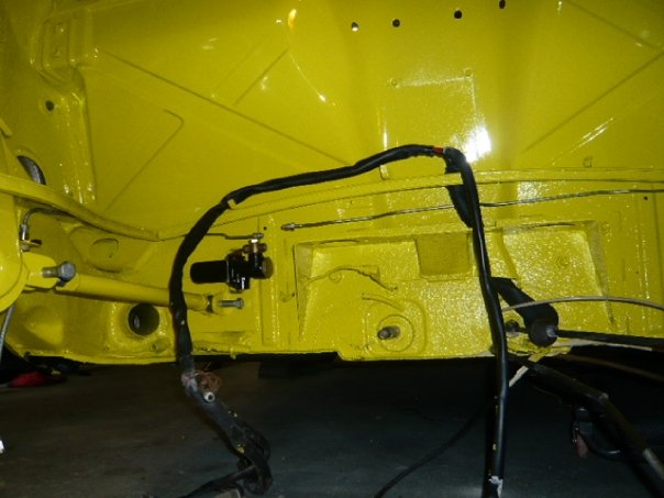

QUOTE Rich had it first Fairly certain Velious made that mount first. (IMG:style_emoticons/default/wink.gif) One supplier (kinda like back in the days 914 guys had one parts retailer) could lead to massive price gouging of the end consumer. (IMG:style_emoticons/default/wink.gif) RJ Mount is in mine. Yes, it includes the 911 "Sport" engine mounts. (IMG:http://www.914world.com/bbs2/uploads_offsite/sphotos.ak.fbcdn.net-1110-1284408488.1.jpg) |
