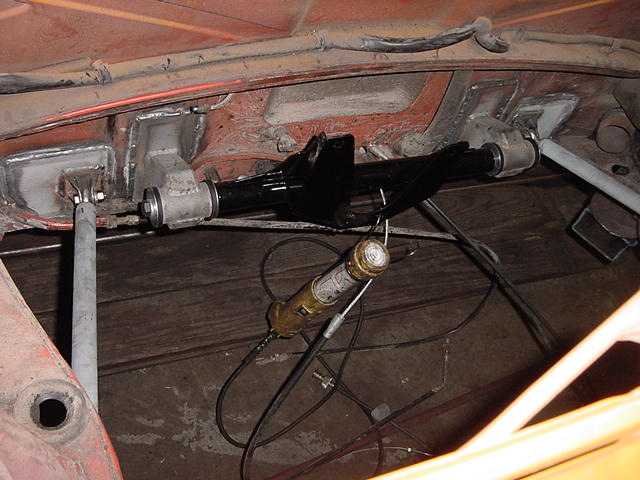

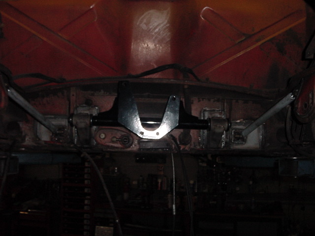

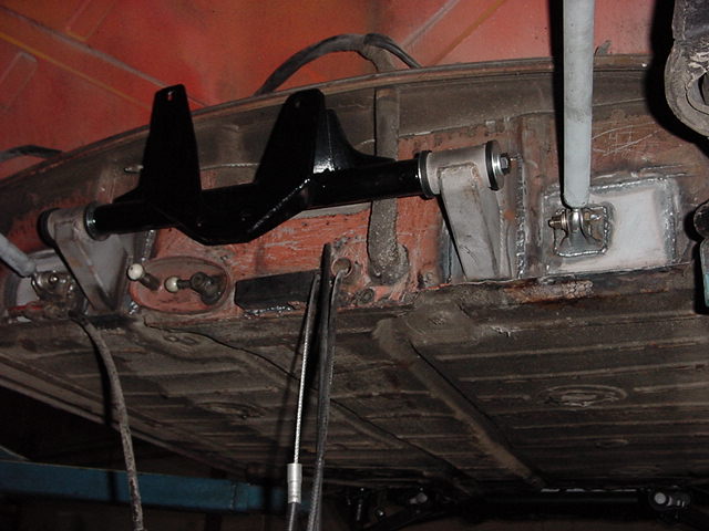

Just had the Patrick mount installed in my project track car. The ability to pivot makes it easy to work on some areas of the engine without having to remove it completely. With my luck at track events, this may come in handy.

brant The Patrick mount is much better for engine servic... Sep 7 2010, 07:03 PM

brant I pull my carbs for full removal
but for tipping,... Sep 9 2010, 09:12 AM
