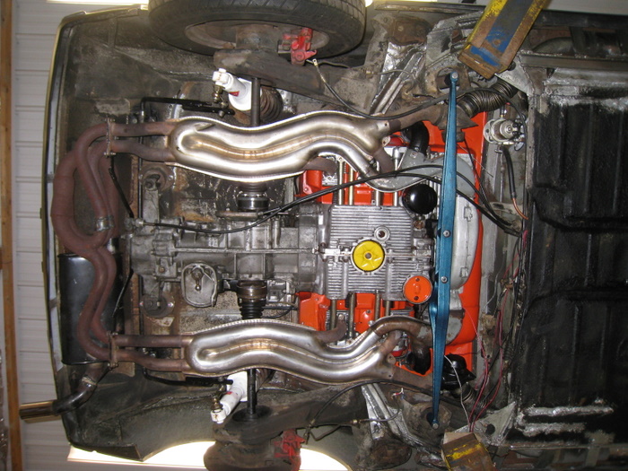

After way too long, I'm back on this project.
Here's a teaser pic...
(IMG:http://www.914world.com/bbs2/uploads_offsite/www.ephotomotion.com-8571-1284681833.1.JPG)
I still have to connect the throttle linkage and shift linkage. And I have a little bit more wiring to do. And I have to put the carpet and seats back in...
