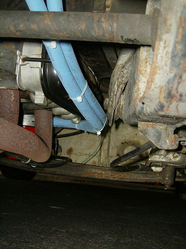

Brant, I PM'd you some pictures.
Routing the lines through the sheet metal, while clean, is risky even with grommets on all of the sheet metal passages.
Running next to the valve cover is less of a risk (in my opinion) and easier to inspect and/or replace the hoses. They are also plenty far away from the exhaust. The hoses easily pull out of the way to pull the valve covers and adjust the valves.
The hoses are tie wrapped together making them stiff yet not to require any additional support yet flexible enough to allow for movement and expansion.
The picture below is from 2 years ago when I first installed the cooler. The car has since been driven about 10,000 miles and multiple track events with no oil issues.
