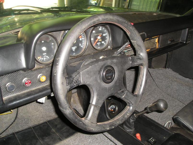

kphimself   Does anyone know or have a picture of where the fo...   Sep 22 2010, 07:59 PM
dlee6204   Here is a picture for you. Its the yellow one. The...   Sep 22 2010, 08:07 PM
kphimself   Thanks, i found the switch as well just didn't...   Sep 22 2010, 08:10 PM
