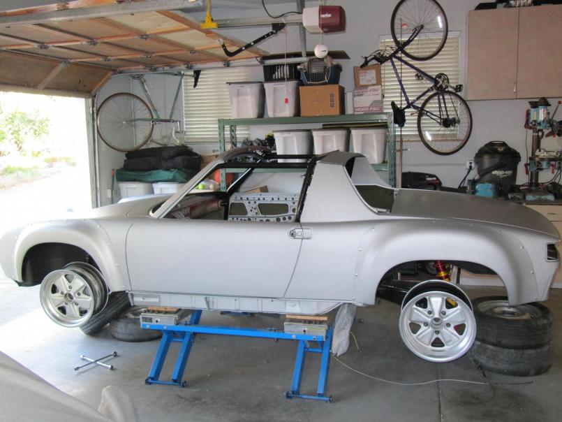

This car will handle like it was on rails so I'm deleting the tires and setting th car up with a flux capacitor! I paint stripped the wheels. I was stoked at how cool they look naked I had to put them on! I am not painting them.
