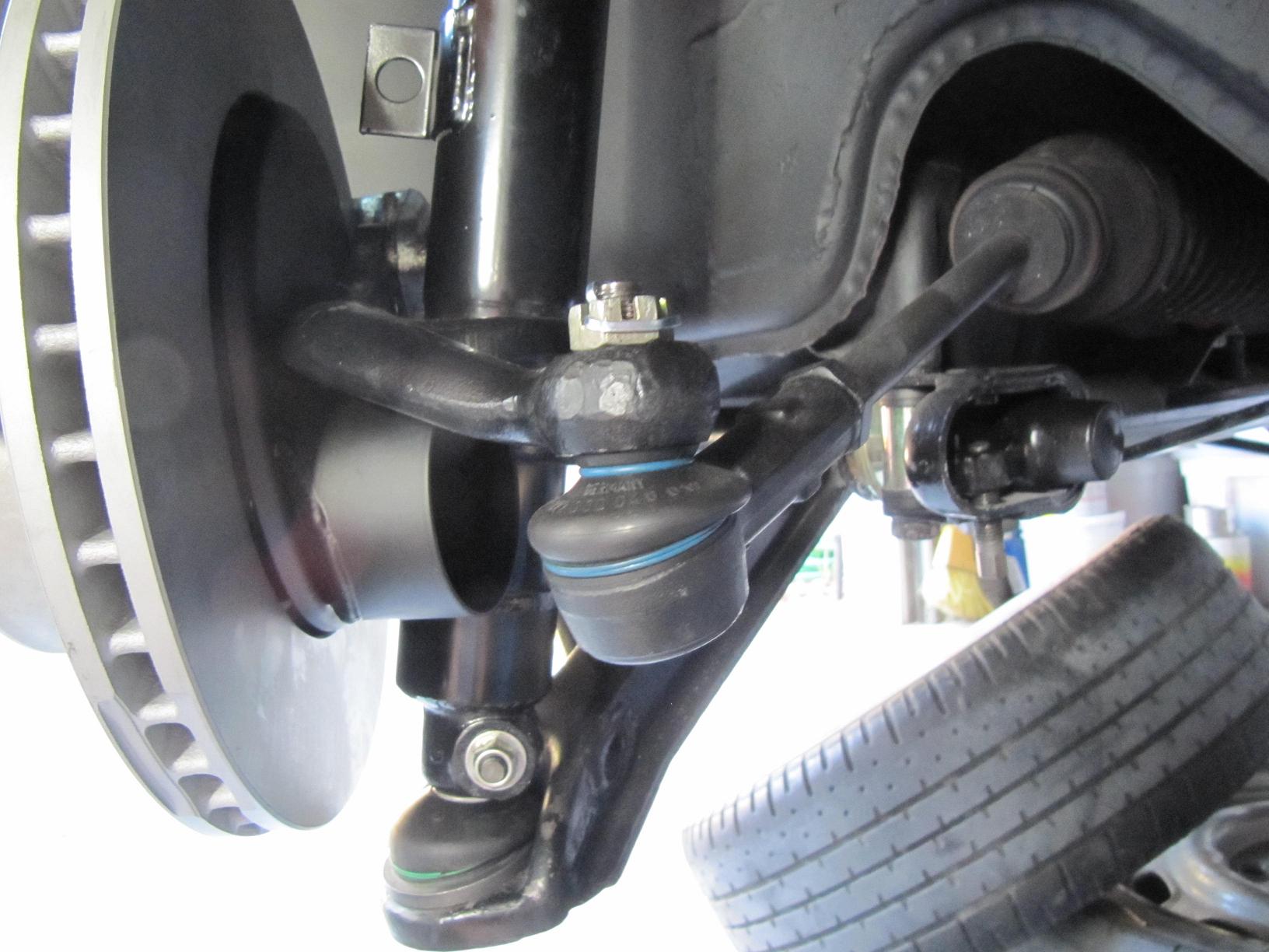

Front suspension detail: Carrera front struts/brakes- Konis, turbo tie rods, elephant polybronze bushings, low friction rear mounts only. 22mm bars, vented backing plates/ hub block offs. Chassis reinforcing for sway bar. (IMG:style_emoticons/default/welder.gif)
oh, I do have a Tarret front sway bar, but I'm leaving that for a rainy day.
Edit: 21mm torsion bars
