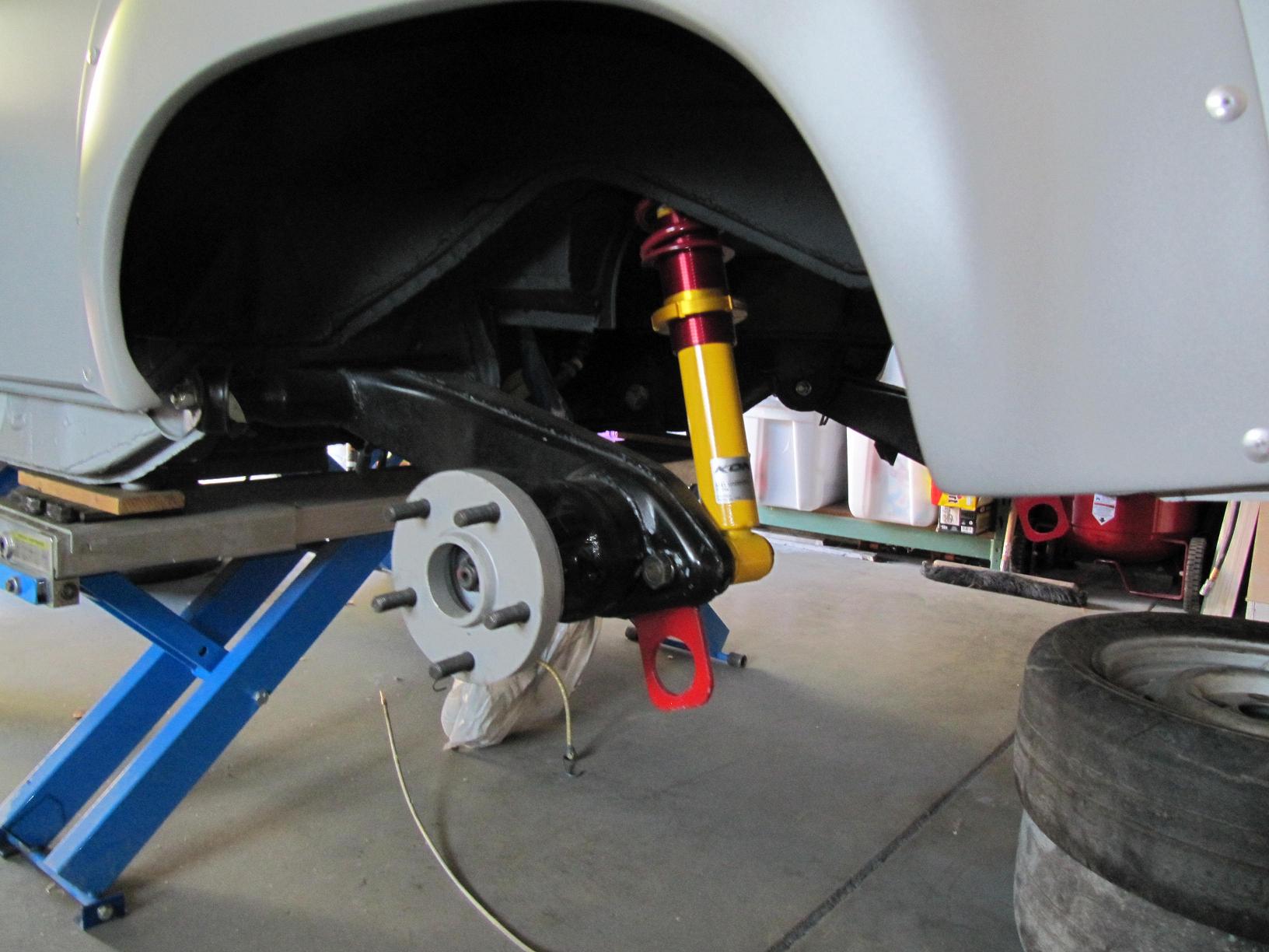

Rear suspension detail: Elephant polybronze, Koni adjustable, Ground Control adjustable sleeves. 250# springs
Not shown: SC rear brakes
Edit: 200# springs

Krieger   Front suspension detail: Carrera front struts/bra...   Sep 26 2010, 11:27 AM
Krieger   Rear suspension detail: Elephant polybronze, Koni ...   Sep 26 2010, 11:32 AM
