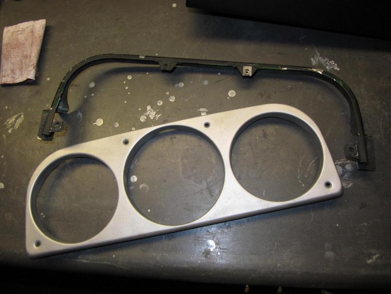

As you can see the dimensions are similar to the stock steel dash frame. I cut off the steel frame that holds the gauge plate and will be bolting that on once the aluminum is bent up. I will be using the stock gauge face plate as well. Gauges will be 911 oil temp/pressure combo, 911 tach, 914 150 mph speedo. Down on dash face the single cut out is for fuel. Thats all I'm doing so far. I want to drive this freakin thing. I am going to spray the dash with black wrinkle paint. Aluminum is so much easier to work with!

Krieger   Of course I wanted something different for my dash...   Oct 17 2010, 09:36 AM
Krieger   As you can see the dimensions are similar to the s...   Oct 17 2010, 09:46 AM

Krieger   Here is the dash bent up. I paid the shop where I...   Oct 24 2010, 06:54 PM
Krieger   Here is the gauge hoop bolted up. A little more f...   Oct 24 2010, 06:59 PM
