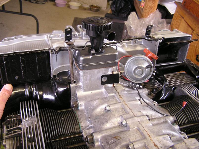

Hi,
Is this the correct positioning for the cooling flaps with a cold unexpanded bellows?
Somehow I think the rod may have been bent or the flaps twisted by the previous owner. I want to hook up the thermostat so I can have a wintertime heater.
Thanks...Dan

So the flaps are both "up" or closed like this? As such, I will bring more cable through...correct?
Thanks...Dan

Sleepin   That is the hot position IIRC.   Oct 24 2010, 11:07 AM
StratPlayer   Thermostat cable connects with the connector in th...   Oct 24 2010, 11:11 AM

Jake Raby   In the HOT position the diverter over the oil cool...   Oct 24 2010, 12:56 PM

cdadaa   Thanks Jake...that makes sense. I'm good to g...   Oct 24 2010, 05:31 PM
gasman   Looks like you have the heads on the wrong sides.....   Oct 24 2010, 05:41 PM
cdadaa   Look again...I believe the CHT is on the passenger...   Oct 24 2010, 05:53 PM

ziggy   Were the cable running to the thermo to break, wou...   May 9 2011, 08:25 PM
McMark   ONLY attach the wire with the flaps in this positi...   May 10 2011, 12:00 AM

MikeM   Just to be clear....I'm missing some parts fro...   May 12 2011, 07:38 AM
vsg914   Mike, the default is to the hot in case the cable ...   May 12 2011, 09:33 AM
SirAndy   Mike, the default is to the hot in case the cable...   May 12 2011, 10:55 AM
Root_Werks   I see three major points that have been made to th...   May 12 2011, 12:17 PM
MikeM   Thanks guys...if I would have thought about that f...   May 12 2011, 07:51 PM
avidfanjpl   Mike, On the standard temp gauge in the console i...   May 12 2011, 09:24 PM
914Mike   ... On a cold motor, flap bolt tiedown should be...   May 13 2011, 01:11 AM
avidfanjpl   Everyone has an opinion based on experience on the...   May 13 2011, 01:29 AM
