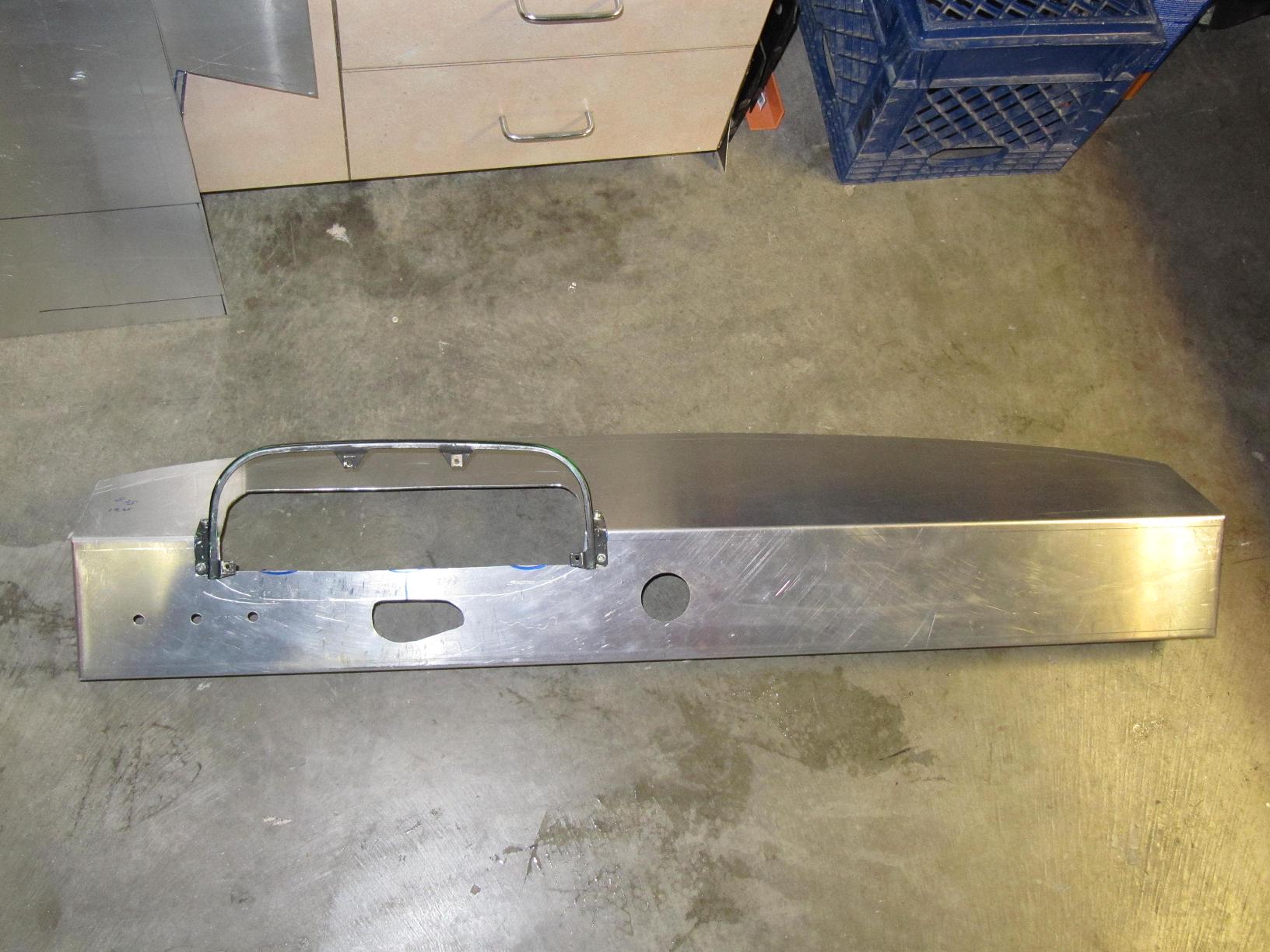

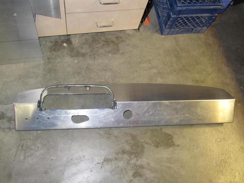

Here is the dash bent up. I paid the shop where I buy materials to do this $35. I had to trim the corner tabs on top of the dash. When I drew this thing up I wasn't sure if I could install the dash with these corners with the roll cage installed in car. I cut them off. The aluminum sheet is .80 thick. The top bend is 110* just like stock.

Krieger   Here is the dash bent up. I paid the shop where I...   Oct 24 2010, 06:54 PM
Krieger   Here is the gauge hoop bolted up. A little more f...   Oct 24 2010, 06:59 PM
