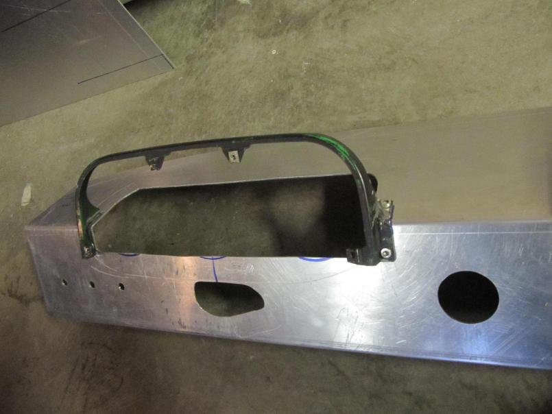

Krieger   Of course I wanted something different for my dash...   Oct 17 2010, 09:36 AM
Krieger   As you can see the dimensions are similar to the s...   Oct 17 2010, 09:46 AM
gothspeed   Great job!!! :beer1:   Oct 17 2010, 11:02 AM

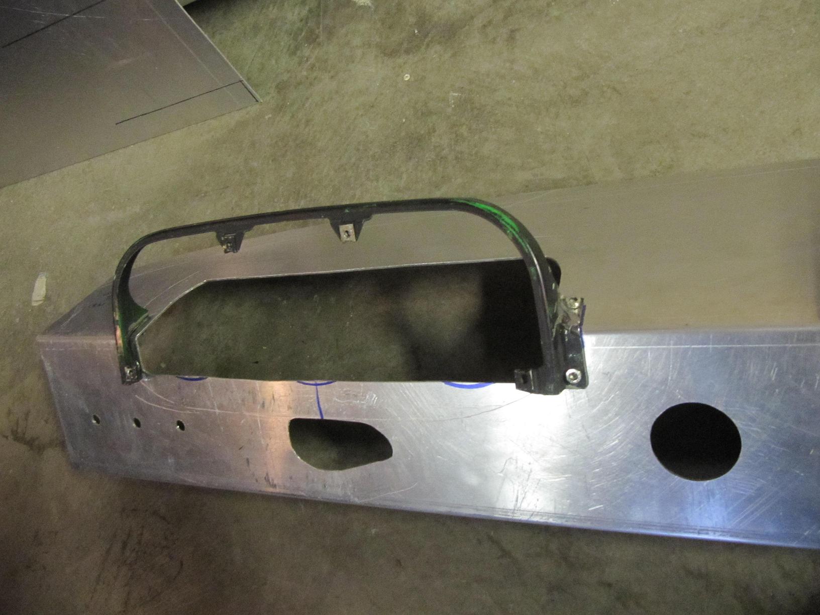

Krieger   Here is the dash bent up. I paid the shop where I...   Oct 24 2010, 06:54 PM
Krieger   Here is the gauge hoop bolted up. A little more f...   Oct 24 2010, 06:59 PM
