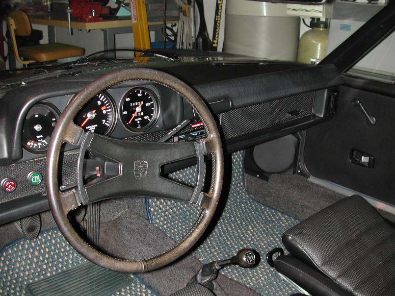

This is as far as I got.

Rod   Wow!!! Very cool!!! Got...   Oct 28 2010, 04:13 PM
windforfun   Wow!!! Very cool!!! Go...   Oct 28 2010, 04:22 PM
