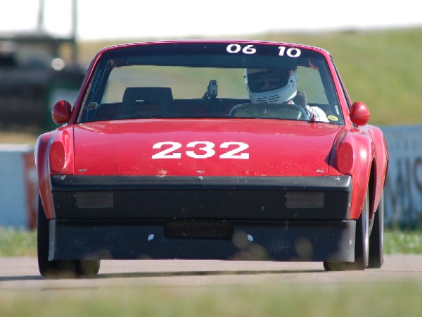

I like:
23.5 Torsion bars front
22 Front sway bar (Weltmeister w/ fully adjustable drop links) set about half soft (use this to adjust balance)
400# rear springs
Adjustable red Koni's in front (set about mid range)
Re-valved Bilstein yellow rear
No rear sway bar
245/45 R16 Kumho Victoracers all around
The car is very neutral, very easy to turn in, very easy to 4-wheel drift. It runs very flat through turns.
Granted, this is a track only car.
(If you do the math and figure out the spring rates, this setup is scalable. The front to rear spring rate ratio makes the car neutral. The front sway bar is used to fine tune)
Had been hard plastic bushings all around, but now elephant poly-bronze all around.Attached Image
