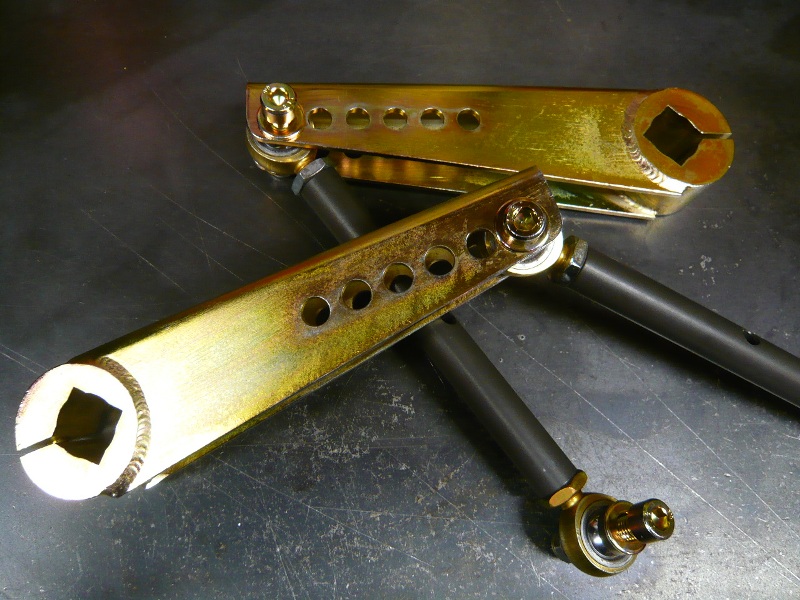

I don't think it's $675.00. It's a cool concept on a bar GPR had made especially for them. I believe it's an 18mm bar (I love my factory 18mm bars) and it has the adjustable drop links so... if your ride is too harsh you can move them to the ends and it would effectively be more like a stock 15mm bar. I think it's a great bar for street and beyond. Very cool multipurpose bar.

I used the Tarret RSR arms and drop links on my factory 18mm bars. We'll see how it turns out:
