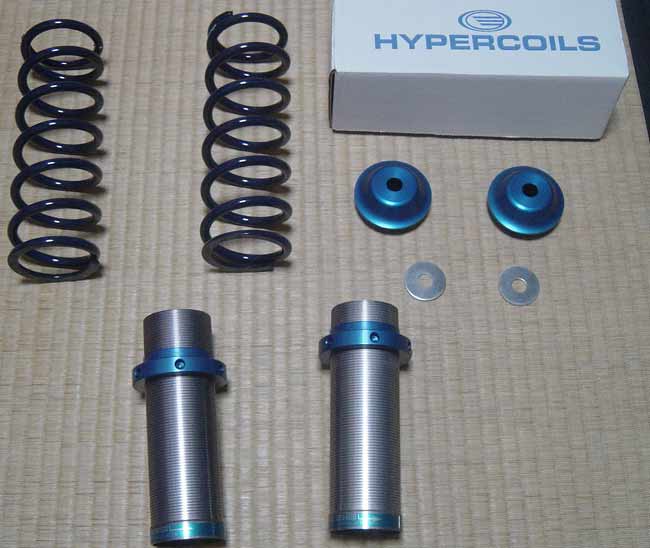

Wow, thanks for all the answers and advice on this thread....I have decided to keep my Tarret 150 pound springs with the adjustable height perches and also keep the stock 911T T bars up front which I believe are 19mm and slightly stiffer than the 914-4 T bars....I am going with Koni shocks all around, Elephant bushings, turbo tie rods, new ball joints and and am waiting for some answers from some shops about the front sway bar, either the Tarret bar or the GPR bar...mostly its going to be a street car but not a daily driver, a fun weekend car to have some fun with. Here is a picture of my latest parts from Tarret with the 150 pound springs.
Cheers
(IMG:http://www.914world.com/bbs2/uploads_offsite/www.dreamgate.ne.jp-8305-1289035646.1.jpg)
