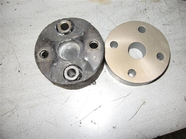

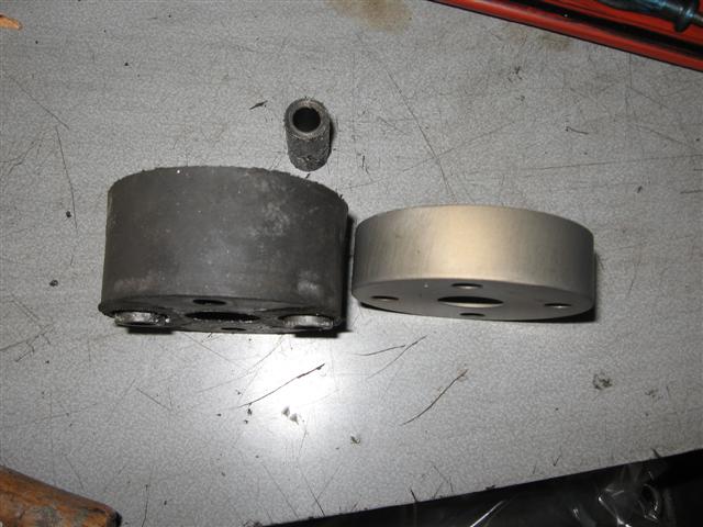

I recall getting the coupler from BRAG Automotive. Here is a Link , but the coupler looks taller; mine is shorter to make up for the raised steering rack (bump steer). On second look BRAG offers the shorter version. I just had to read to find it...
Pictures of mine:

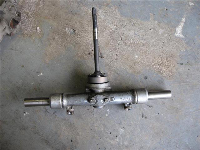

tradisrad   Hey guys, I am going to hijack a bit but I wont ch...   Nov 3 2010, 08:13 AM
DanT   Rob, by stock linkage do you mean you have no adju...   Nov 3 2010, 08:40 AM
tradisrad   Dan, that is correct I have stock, non adjustable...   Nov 3 2010, 08:50 AM
Eric_Shea   I would do one of two things with that set-up for ...   Nov 3 2010, 09:15 AM
DanT   :agree: :D   Nov 3 2010, 09:17 AM
tradisrad   where can i get a 19mm bar to use with my stock ar...   Nov 3 2010, 09:19 AM
DanT   yes a 911 thru body bar will work and there are lo...   Nov 3 2010, 09:22 AM
Eric_Shea   Most early 911 thru-body bars are 16mm. They star...   Nov 3 2010, 09:28 AM

tradisrad   I ordered the GPR bar and after driving my 914 for...   Nov 7 2010, 06:39 PM
nsr-jamie   I ordered the GPR bar and after driving my 914 fo...   Nov 7 2010, 09:49 PM
tradisrad   I recall getting the coupler from BRAG Automotive....   Nov 7 2010, 10:32 PM
nsr-jamie   Hi, thank you!! Those are awesome pictures...   Nov 9 2010, 07:52 AM
tradisrad   Jamie, As far as I know Brad is the only guy that ...   Nov 9 2010, 08:17 AM
7275914911   Jamie, CFR has one that is solid tho not billet. ...   Nov 9 2010, 01:22 PM
