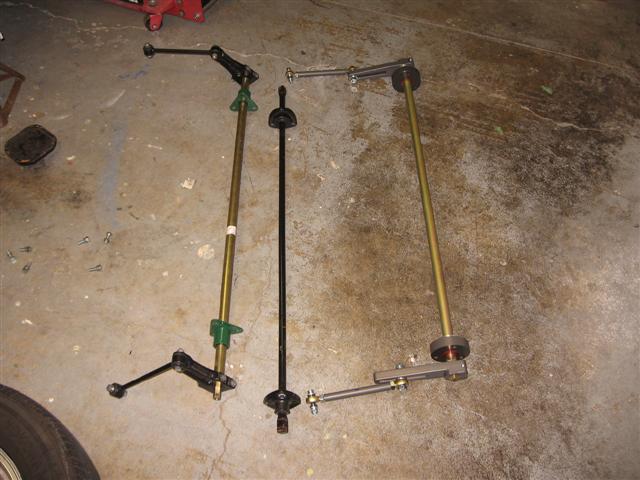

The New GPRBar is installed. I took it for a short test drive and it really seems to be what I was looking for as far as performance.
The install was straght forward and from start to completion of test drive I spent about 2 hours. Probably the most challening part was getting the bar through the second mount. I found that I had to loosen the mounts and I was able to get the bar through w/o much trouble.
Comparison of sway bars. 22mm Weltmeister w/factory arms; stock bar; GPRBar.

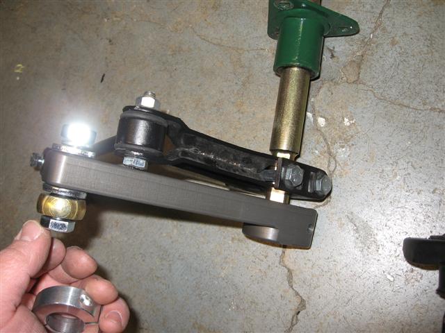

Factory arm length compared to GPRBar

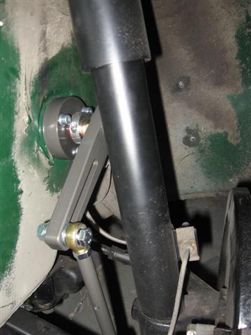

Installed pic

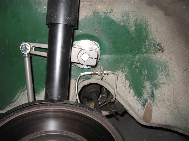

installed pic; looks like I need to clean some more grime from the wheel wells

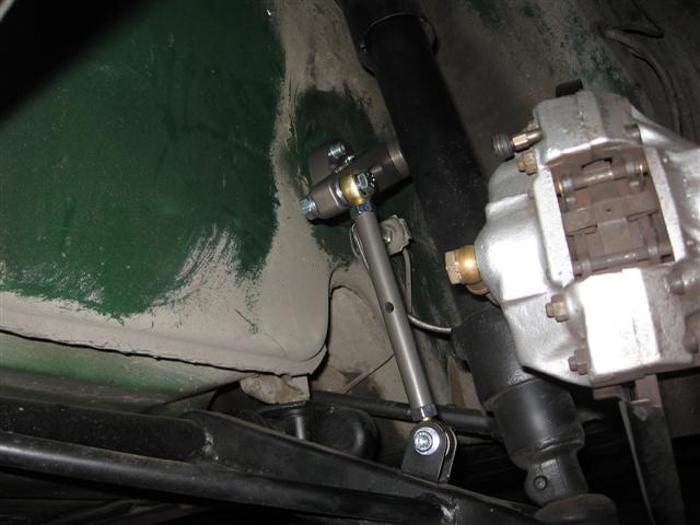

Installed pic. Pass side
one more
