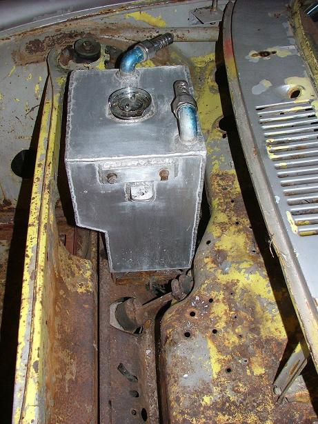

Been planning how the oil system will work. This is the oil tank that came with the
car. It looks like it was custom made. I am pretty sure I have seen other oil tanks
with the same shape and in the same location as the one in this car.
Here is where the tank fits in the car.

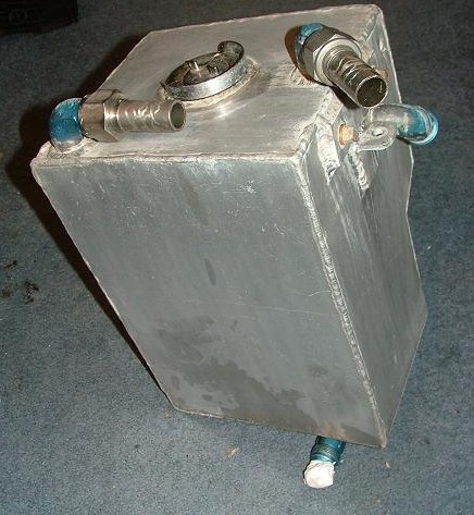

The tank has internal plates that slope down to a hole in the center. I think the
-20 fitting on the side is where oil would enter the tank and drain down into the
lower portion. The -20 fitting on the bottom is the return line to the engine. It
runs into the passenger area then into the long and out into the engine bay.
I am guessing the two fittings on the top are for engine breathers?
I am new to /6 engines and am trying to plumb the mysteries of the oil system. I
think I can use a 993 oil filter console on the engine to replace the engine mounted
oil cooler. I think the oil scavenge pump will feed oil to the front of the car into a
thermostat. The thermostat will either feed the front mounted oil cooler and then
into the side fitting of the oil tank, or it will send the oil directly into the oil tank.
From there its out the bottom of the tank and back to the pressure pump on the engine.
I'm thinking of buying a new oil cooler for the car. I have an old RX7 cooler I could
have cleaned and tested but /6 engines are too expensive to screw up with a used
$50 oil cooler.
Any advice or suggestions on the above would be appreciated.
John

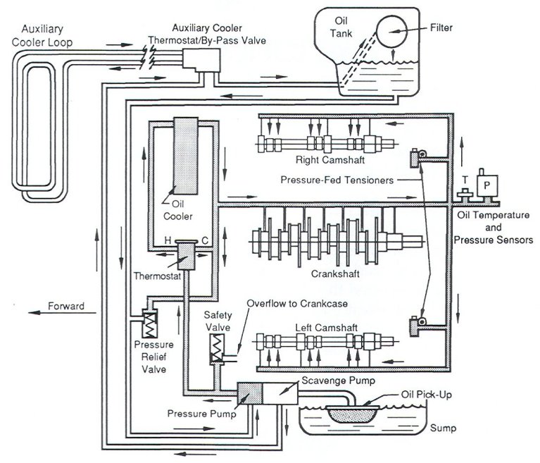

John here is a diagram of oil system with cooler.
Your oil tank is most likely custom as was the norm for Private IMSA teams.
The oil would generally come into the tank at a higher level and drip thru a screen to remove air from the oil. The scavenge side of the oil pump will push the oil thru the cooler and into the tank.
