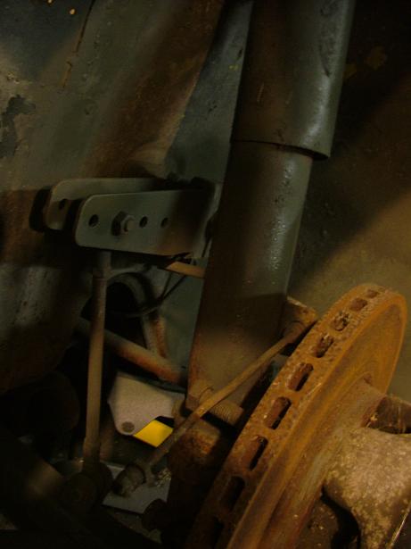

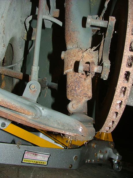

Looking at the struts and sway bars on the car. Does anyone recognize this sway
bar arm? For some reason, RSR comes to my mind.
Struts are too rusty and dirty to tell what they are without cleaning. They do have
3.5" brake caliper spacing. Not sure if the struts are salvageable. I sprayed some
etching primer in there to prevent further rust.

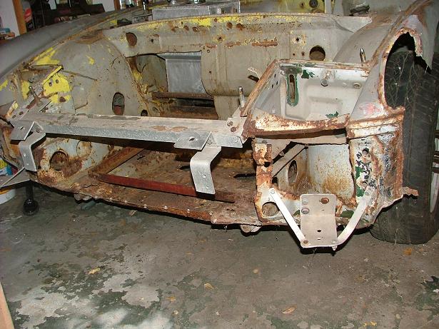

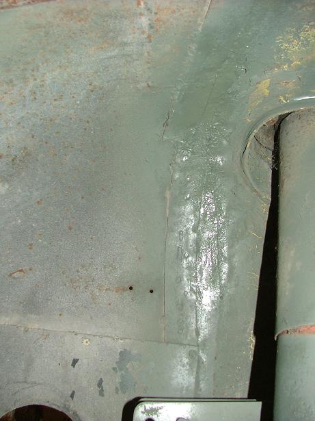

Looks like the front right fender was replaced at some point. Kind of a hack job.
The whole front end was wrecked at some point and replaced with this aluminum
bar. I plan to replace the front trunk floor and front valence panel, then add a
GT style radiator and shroud.
I think the car started its racing career more like a normal GT and got franken14ed
later after some accident. I think the car will be much nicer if I return it to the way
a 914GT would have looked.

QUOTE(FourBlades @ Nov 9 2010, 07:30 PM) *
This looks like an aftermarket Charley Bar, it was somewhere around 22mm.
