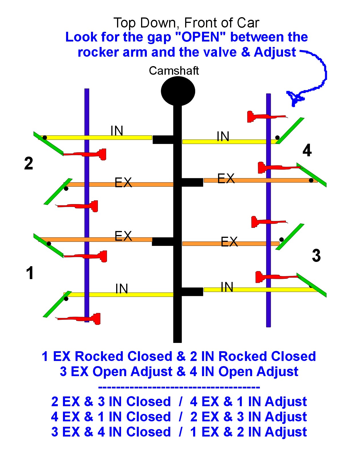

3A. Using the unblocked road wheel as a hand wheel,
rotate the engine until the rockers are rocking in accordance
with the first entry in the table below. Adjust the clearances
of the corresponding valves as shown in the table. Continue
rotating engine and adjusting valves until all have been
done. Re-install valve covers.

4. Valve adjustment table: # denotes cylinder number;
Ex = Exhaust valve; In = Intake valve.
Turn until Rocking: Adjust:
#2 Ex & #3 In #4 Ex & #1 In
#1 Ex & #2 In #3 Ex & #4 In
#4 Ex & #1 In #2 Ex & #3 In
#3 Ex & #4 In #1 Ex & #2 In
It follows logically that a valve opposite one that is open is
on the back of the same cam lobe, the perfect place for
adjustment. It is only necessary to be certain of which
valves actually share the same cam lobe, which can be a
little tricky owing to the offset nature of the cylinder layout.
However, I believe that I have done this, and that
further, I have worked it out so that, if the valves are
adjusted in the order given in the table, a minimum amount
of engine rotation will be necessary to complete the task.

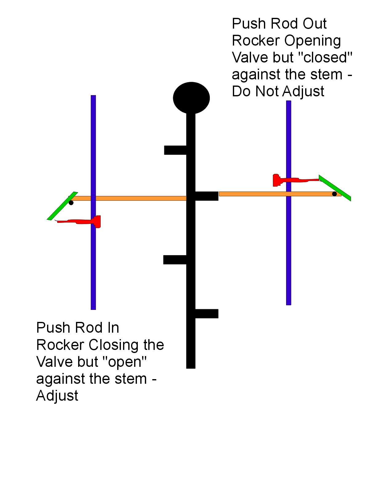

First, a definition of the term "rocking". The name that is usually
applied to the levers that convert the direction of travel of the pushrod
(out) to valve motion (in) is "rocker arms". Therefore, by definition,
rocker arms "rock", or pivot about the "rocker shaft", the gizmo that they
are mounted on. So "rocking" is observed movement of the rocker arm for
the valves mentioned in the first column of the table.
Once you have the PAIR of valves in the FIRST column of the table open
(rocker arms rocking, rather than in valve closed position) it is then
correct to adjust the CORRESPONDING PAIR of valves in the SECOND column of
the table (on the same line, or row of the table).
In other words, you would rotate the engine (by turning the
road wheel with the car in gear) until the # 2 exhaust and
the # 3 intake valves were observed to open (observed
motion of their rockers). When you have both of these
valves open, you can then proceed to adjust # 4 exhaust
and # 1 intake. This completes the first line of the table,
and you have two valves adjusted. You then proceed to
the next line of the table, and look for motion of the "que"
or "indicator" valves in the first column, and adjust the
valves in the second column. This process continues
until you have completed all four lines in the table,
adjusting two valves per line.

The cylinder layout is pictured on page 63 of the Haynes book; fig. 3.3.
The intake valves are the pair in the center of the heads; the exhaust
valves are the outermost valves. The engine layout is such that the valve
layout for the LEFT side of the car is as follows (from front to rear):
# 2 Ex # 2 In # 1 In # 1 Ex
and on the RIGHT side of the car, from front to rear:
# 4 Ex # 4 In # 3 In # 3 Ex
The reason was detailed in the complete procedure that I posted,
but perhaps it was not clear. Given that the best place to adjust
valve clearance is when the lifter (follower, tappet, whatever you
prefer) is on the BACK or circular part of the cam lobe, i.e.
opposite to the bump, then the problem simply becomes one of
positioning the cam so that it's back side is adjacent to the lifter
of the valve that we wish to adjust. Because of the valve train
layout of the flat-four, this is most easily done.
If you have a Haynes book, look at the illustration on page 26.
Near the bottom of the page is a pretty good picture of the 914 cam
shaft. Count the lobes. You will observe that there are only
four... but the engine has eight valves! The VW flat four is the
only engine that I know of to use this unique layout. The camshaft
has two exhaust lobes, and two intake lobes. Each lobe actuates two
valves on opposite sides of the engine; thus we can operate 8 valves
with only 4 cam lobes.
However, this brings up an interesting observation: If a
particular exhaust valve, for example, on the right side of the
engine is open, then it must be that the opposite exhaust valve is
fully closed; i.e. it's lifter is on the exact opposite side of the
cam lobe from the "bump". Referring back to our "given" above, this
is the perfect place to adjust the valve OPPOSITE to the one that is
open.
If you look at figure 3.3 on page 63 of the Haynes book, you will
see the engine cylinder layout.
The first entry in my table says: turn until rocking - # 2 exhaust
and # 3 intake. If you look at the engine layout, you will note that
the exhaust valve for # 4 is opposite to # 2 (the one that is open),
and likewise the intake for # 1 is opposite to # 3 (the open intake
valve). Therefore, at this point, we should logically adjust # 4
exhaust and # 1 intake, and referring to the table, that's exactly
what it says.
The rest of the table was derived simply by turning the engine in
it's normal direction of rotation and observing which valve pairs
rocked together next, and then noting their opposites to be adjusted.

In the case of the flat-four, we have a unique valve layout that
readily allows us to find the point opposite to the peak of the lobe.
This is because the same cam lobe operates a valve first on one
side of the engine, and then on the other. For example, when the
exhaust valve on cylinder # 2 is open, the exhaust valve on cylinder
# 4 is as closed as it's going to get, because the tappets for both
valves are riding on the SAME cam lobe, 180 degrees apart. Hence,
whenever the exhaust valve on # 2 is open, the tappet for the exhaust
valve for # 4 is on the back of the cam lobe, where the adjustment
should be made. To save time and effort, it will be noted that when
the engine is rotated, there are four places in the rotation where
two valves are open at once. It is at these four places that the
same type of valve (i.e. intake or exhaust) on the OPPOSITE cylinder
can be adjusted. The procedure that I have written up will enable
this to be done with a minimum of effort.
