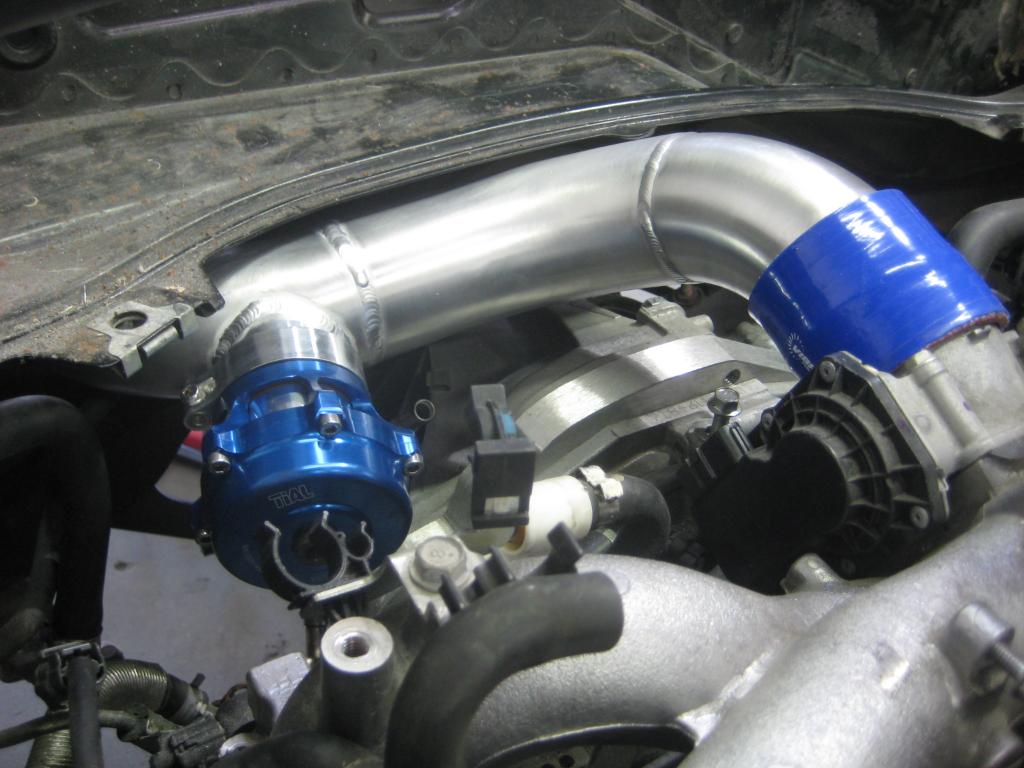

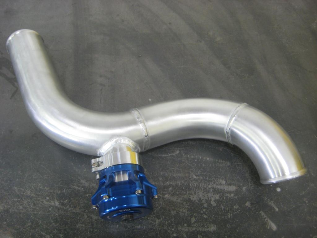

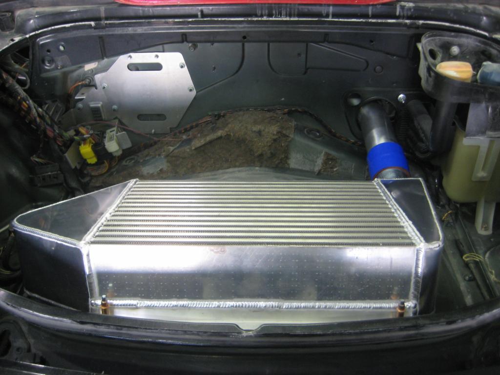

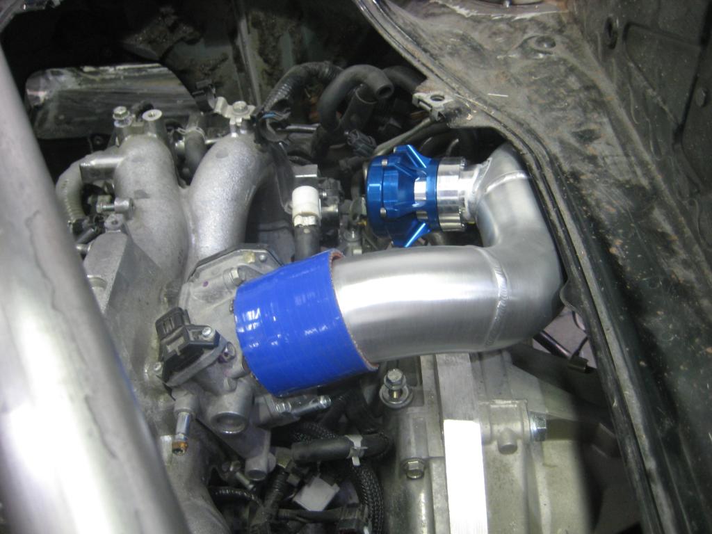

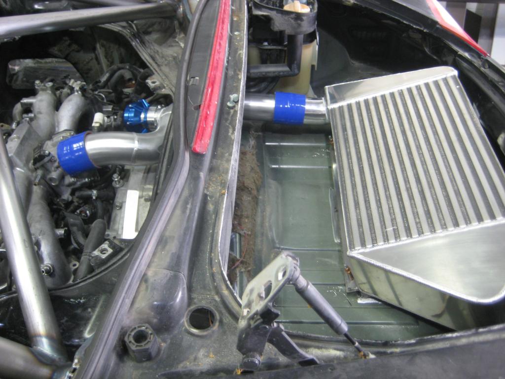

Intercooler plumbing finished. That's it. Only one short section of tube on the cold side. The hot side is just a 2"-2.75" coupler from the turbo to the intercooler so no plumbing there. The engine and transmission are now out so I can do all of the engine service work (TGV delete, gaskets, injectors, fuel rails, leak-down test blah... blah...) and install the flywheel. The next time the engine goes in the chassis will be to try and start it. Time to finish the cage, do the body work, and paint the thing...
(IMG:http://www.914world.com/bbs2/uploads_offsite/i180.photobucket.com-11979-1289697671.1.jpg)
(IMG:http://www.914world.com/bbs2/uploads_offsite/i180.photobucket.com-11979-1289697672.2.jpg)
(IMG:http://www.914world.com/bbs2/uploads_offsite/i180.photobucket.com-11979-1289697672.3.jpg)
(IMG:http://www.914world.com/bbs2/uploads_offsite/i180.photobucket.com-11979-1289697672.4.jpg)
(IMG:http://www.914world.com/bbs2/uploads_offsite/i180.photobucket.com-11979-1289697672.5.jpg)
