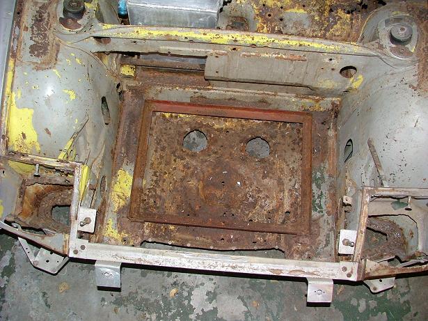

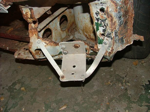

More hideous rust and damage pictures. The front trunk floor is basically falling
apart. They cut a big hole in the bulkhead in front of the oil tank for some reason,
maybe cooling because there is another hole in the floor under the oil tank?
They added these brackets and mounted driving lights that aim through holes in the
bumper. I will keep this and mount some new lights here.
I would probably be better off just replacing the entire front end of the car right in
front of the shock towers. Not sure if that is a realistic plan. I am afraid the front
suspension mounting points are shot.
Will probably piece it all back in as I can find rust free replacement sheet metal.
Hint hint. Will pay for time and shipping.
John

QUOTE(FourBlades @ Nov 9 2010, 08:39 PM) *
John

FourBlades   More hideous rust and damage pictures. The front...   Nov 9 2010, 06:39 PM
tscrihfield   More hideous rust and damage pictures. The fron...   Nov 11 2010, 04:52 PM
