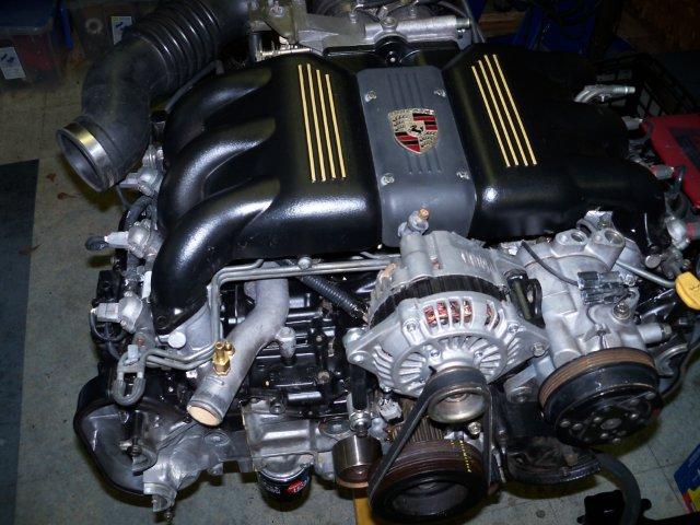

BIGKAT_83
post Nov 18 2010, 11:02 AM
Posts: 1,800
Joined: 25-January 03
From: Way down south Bogart,GA
Member No.: 194
Got the engine out of the car now. I needed to clean up a few odds and ends. I added the AC/compressor for the AC I'm installing. I also did a little clean up on the engine. I was getting a oil leak at the camshafts. The engine was sold to me with the owner saying it had 105K miles. I pulled the heads off and this thing looks brand new. I can't get over how nice these Subaru's are.
Added a little bling too.
