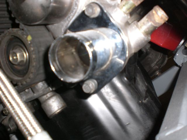

Britain Smith   Do you happen to have a picture of the thermostat ...   Nov 18 2010, 11:15 AM
BIGKAT_83   Do you happen to have a picture of the thermostat...   Nov 18 2010, 11:23 AM
d914   here is th straight neck thermosat housing..   Nov 18 2010, 03:02 PM
