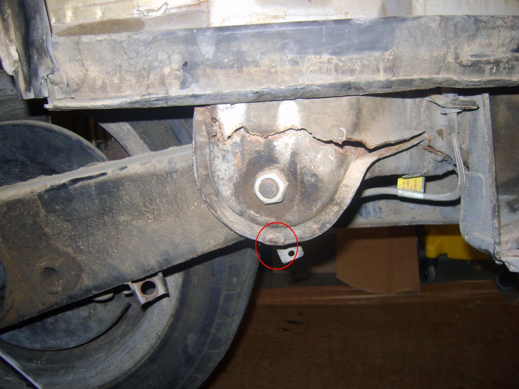

So I dropped the motor and what do I see?:
(IMG:http://www.914world.com/bbs2/uploads_offsite/i366.photobucket.com-10819-1290372313.1.jpg)
Can I just re-weld this, or do I need to remove the whole piece and put in a new one?
I suppose I should do both sides while I am at it?
Any suggestions?
Stu

post Nov 22 2010, 10:13 AM
Posts: 927
Joined: 23-January 04
From: ST. Bonifacius,MN
Member No.: 1,590
Just a heads up on prevenative maintenance. There are many stamped drains located throughout the body sheetmetal. Be sure the one circled in red is clear or the the mount will rust from the inside out

Travis Neff   I wouldn't weld it back up, replace it. Troub...   Nov 21 2010, 03:07 PM
Andyrew   New Piece, Do Both..   Nov 21 2010, 03:10 PM
Eric_Shea   Check CFR for a repair piece I believe. Search is...   Nov 21 2010, 03:46 PM
brant   Stu, its common on track cars there is a 914 gur...   Nov 21 2010, 03:59 PM
stugray   OK replace then. I have a plasma cutter & MIG...   Nov 21 2010, 04:56 PM
brant   That picture is a fab mount, but with the -4cylind...   Nov 21 2010, 05:10 PM
Eric_Shea   Brant has a brace similar to this one: http://www...   Nov 21 2010, 05:14 PM

brant   brace You need a spot weld removing drill bit abou...   Nov 21 2010, 07:19 PM
stugray   So if I get the "Rear Pickup Points Reinforci...   Nov 21 2010, 08:58 PM
brant   So if I get the "Rear Pickup Points Reinforc...   Nov 21 2010, 11:38 PM
mepstein   I would think you should replace the console and n...   Nov 21 2010, 09:10 PM
SirAndy   I would think you should replace the console and n...   Nov 21 2010, 09:31 PM
stugray   Thanks for the link - $211 ea. - OUCH!. ...   Nov 22 2010, 09:52 AM
Racer Chris   Thanks for the link - $211 ea. - OUCH!. ...   Nov 22 2010, 10:27 AM

Eric_Shea   Restoration design has the console for $199.0...   Nov 22 2010, 10:30 AM
Racer Chris   Restoration design has the console for $199....   Nov 22 2010, 10:37 AM
SirAndy   Restoration design has the console for $199.0...   Nov 22 2010, 12:18 PM

sixnotfour   The one on ebay is not worth the time to remove it...   Nov 22 2010, 02:25 PM
Racer Chris   The one on ebay is not worth the time to remove i...   Nov 22 2010, 06:24 PM
stugray   sixnotfour, I did a search for "slits",...   Nov 22 2010, 04:44 PM
SirAndy   I did a search for "slits", but didnt fi...   Nov 22 2010, 05:19 PM
