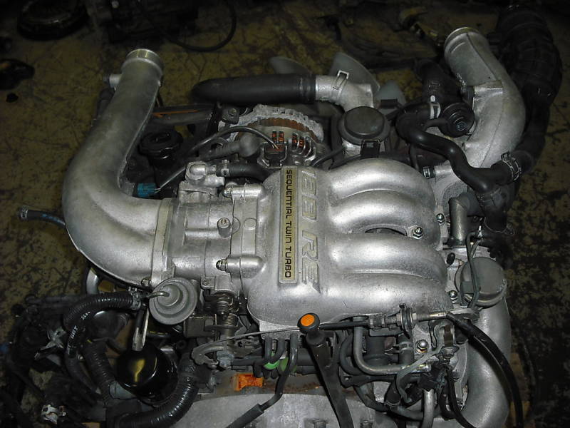

(IMG:style_emoticons/default/drunk.gif) It's on its way. I bought this one because it is complete with all the electronics.
