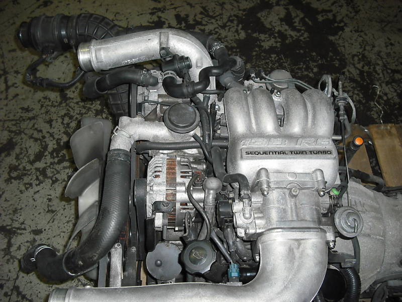

Here's some stock specks from turborx7.com
" The system operates off one turbo during lower RPM's (after 2,000 RPM) and the secondary turbo spools up after the engine reaches the 5,000 RPM level. "...
" The tiny 1.3 liter (two 654cc displacing rotors) power plant put out an incredible 255-hp, and 217 lbs/ft of torque, with the help of twin Hitachi HT12 turbos. "
This the US spec with all the smog equipment. When you remove the Ac, air pump, radiator fan, open the exhaust, improved intercooler, improved air cleaner... etc... I should hit my HP goal with little work. I will try not to port the engine as this will decrease to torque and raise the peak HP higher in the RPM range.
With these stock numbers, the car will be faster than my V8. (IMG:style_emoticons/default/cheer.gif) Don't forget, I removed an 800 lb engine and I'm replacing it with a 350 lb engine with more HP. The key is power to weight ratio. It should also be very nimble in corners. As far as mountain twisties? Keep the RPMs up, keep the turbo spooled. (IMG:style_emoticons/default/driving.gif)
