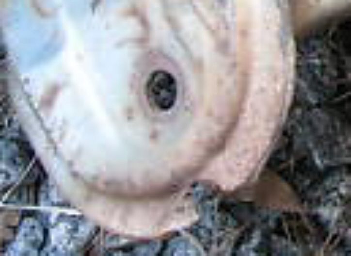

So I dropped the motor and what do I see?:
(IMG:http://www.914world.com/bbs2/uploads_offsite/i366.photobucket.com-10819-1290372313.1.jpg)
Can I just re-weld this, or do I need to remove the whole piece and put in a new one?
I suppose I should do both sides while I am at it?
Any suggestions?
Stu
