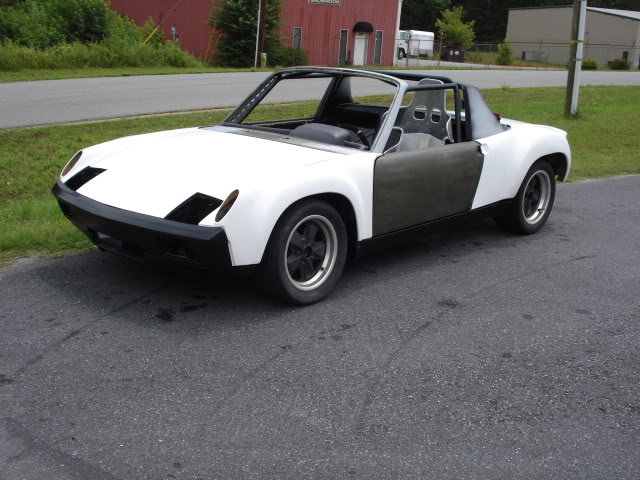

I'll have to dig up the completed pictures, car was racing and winning in August....
(IMG:http://www.914world.com/bbs2/uploads_offsite/i184.photobucket.com-9299-1290563564.1.jpg) |
