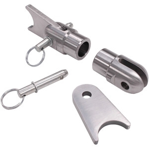

Could/would you make one with the angled side-bars that are removable...so you can take them out for street driving? Would it still be stiff? Also would it be beneficial to add a Perry or Engman long stiff kit along with this?
Man I need a new job so I can afford this! I'll do some figuring and get back to you.

Nathan,
We might be able to do something with these.
(IMG:http://www.914world.com/bbs2/uploads_offsite/www.cachassisworks.com-419-1290997403.1.jpg)
It'll add some cost though and sacrifice some rigidity, and probably aren't smart for actual track safety.
