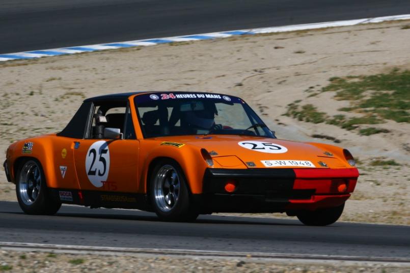

Hi McMark,
Thanks so much for reproducing these. I'm on a never-ending quest to make our (the 914-6 is Tricia's) GT clone a really accurate clone!
I'm investigating my 'secret' 914 funds now to see if I can order one without being kicked out of the house... (I've already ordered the GT headlight kit.. shhhhhhh : )
Just a quick question, which is somewhat OT from the originality. Didn't brant have a post about the safety factor of a side to side bar behind the seats? I thought he promoted the safety of a side to side bar with a T-Bone in the drivers door?
I'm not proposing you add these, but just want to respond to the previous posts and offer the thought that they are functional and do add some safety.
Thanks again for offering this exciting GT product! I'll be in touch
Greg
