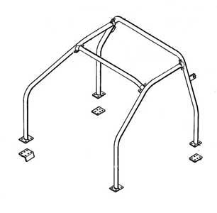

(IMG:style_emoticons/default/blink.gif) Looks pretty different to me...
(IMG:http://www.914world.com/bbs2/uploads_offsite/www.stableenergies.com-419-1291056813.1.jpg)

jt914-6   That looks a whole lot like a Safety Devices bolt ...   Nov 29 2010, 12:50 PM
McMark   :blink: Looks pretty different to me... http://w...   Nov 29 2010, 12:53 PM
jt914-6   The one I had was from the mid 90's. They may ...   Nov 29 2010, 01:04 PM
McMark   :beer2:   Nov 29 2010, 01:05 PM
