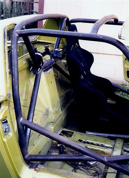

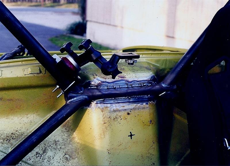

Here's the way mine was done. Instead of the flat piece that goes on the firewall we put in a piece through the firewall connecting all four of the rear brace bars. I would think that would pass for a top to bottom corner bar??? (IMG:style_emoticons/default/idea.gif)

jt914-6   That looks a whole lot like a Safety Devices bolt ...   Nov 29 2010, 12:50 PM
McMark   :blink: Looks pretty different to me... http://w...   Nov 29 2010, 12:53 PM
jt914-6   The one I had was from the mid 90's. They may ...   Nov 29 2010, 01:04 PM

Brett W   SCCA requires a full diagonal to run from the top ...   Nov 29 2010, 01:08 PM
Eric_Shea   I don't recommend any further stiffening kits ...   Nov 29 2010, 02:41 PM
