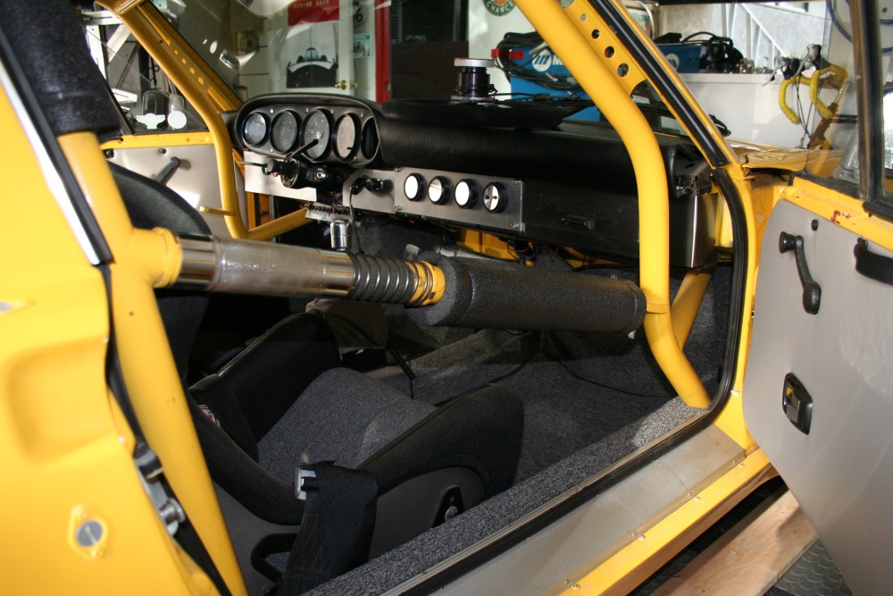

I have no idea where the hardware for this came from but it works pretty good. I'll sell anyone the side bars for $20,000. What the hell, I'll even throw in the car. (IMG:style_emoticons/default/av-943.gif)
structural integrity anyone.
