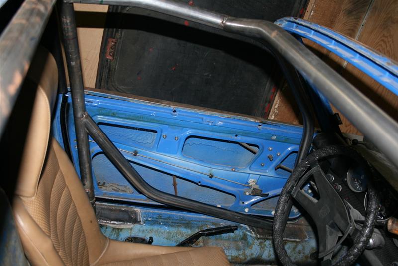

ConeDodger   :bump: Any updates? Actually, Mark was buildi...   Jan 18 2012, 09:04 PM
SirAndy   :bump: Any updates? Actually, Mark was buildin...   Jan 18 2012, 09:16 PM

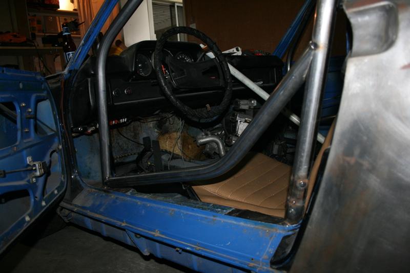

ConeDodger   Did it look like this? (stolen from the Original...   Jan 18 2012, 09:21 PM
SirAndy   Did it look like this? Maybe ... :evilgrin:   Jan 18 2012, 09:41 PM
Zimms   Cool! Thanks for posting pix!   Jan 19 2012, 05:29 AM
ConeDodger   Cool! Thanks for posting pix! Hold on n...   Jan 19 2012, 08:17 AM
