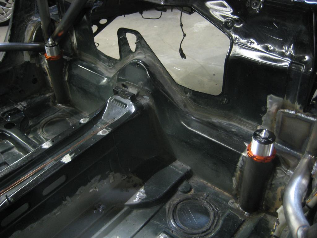

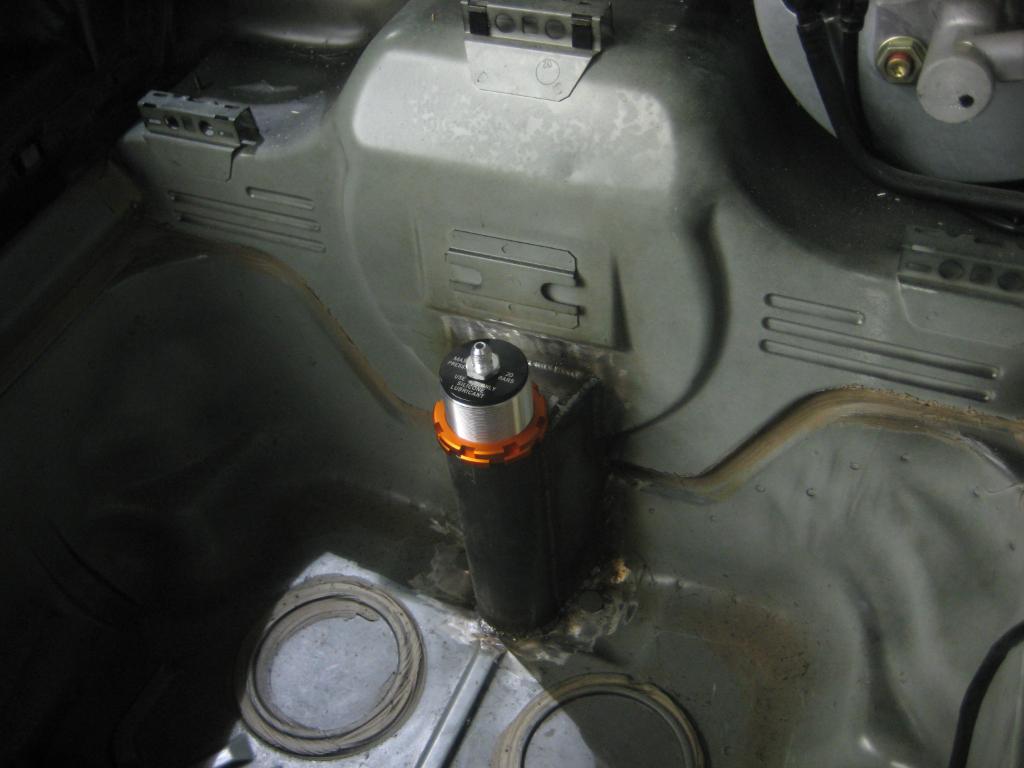

precisionchassis
post Dec 2 2010, 08:01 PM
Posts: 99
Joined: 26-July 10
From: Gilbert, AZ
Member No.: 11,979
Air-Jacks added...
(IMG:http://www.914world.com/bbs2/uploads_offsite/i180.photobucket.com-11979-1291341705.1.jpg)
(IMG:http://www.914world.com/bbs2/uploads_offsite/i180.photobucket.com-11979-1291341706.2.jpg)
