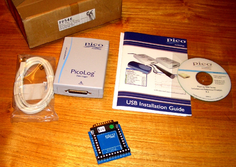

Well, I guess it's time to get back at this. Here's my plan for the near term-
- make some new gasket sets on a laser cutter. I have a sheet of .100" neoprene, and I'll try cutting out the big ring seal and the smaller ring that goes around the outer adjustment nut. Then I can assemble a test MPS using one of the diaphrams that gave a lot of adjustment range, with no leaks (fingers crossed).
- I'm going to try and set up to map vacuum vs. lambda on the fly. I've been thinking about this all summer off and on. I picked up a Pico Technology PicoLog 1012. This is a data logger that plugs into, and is powered by a USB port in a laptop. It actually has 12 channels, but I only will use 2. One channel will be connected to the linear output of my PLX AFR sensor module. This outputs a voltage from 0-5vdc that is proportional to AFR. This is one of the reasons I got the PLX. The second output will log vacuum. To do this, I still need to buy a GM MAP sensor. These were used in many GM models in the early to mid-90's, and they output a voltage 0-5vdc that is linear with manifold pressure from 0-1bar. (There are also 2 bar and 3 bar versions for turbo applications, but I only need 1 bar and they're cheaper- about $35).
I got set up for this with the purchase of the PLX (actually a Christmas gift that I haven't tried out yet, 50 weeks later), and the install of my Walker SS muffler on my Bursch exhaust that I documented in another thread last May While I had the muffler welded up, we installed the bung for the O2 sensor.
I'm thinking the only thing left is the GM MAP sensor, and then hooking it all up.
The data logger came with software that I can set up to capture data (voltages, actually) from both channels simultaneously at pretty much my choice of speeds. It can only capture 8000 data events in it's memory, across both channels, so I'll probably start with 100 events/second, which will give me 40 seconds of data. So as I drive down the road, I'll have someone else with the lap top who can download the data once every 40 seconds or minute or so, and then start collecting again.
The raw data can be downloaded into Excel, and then plotted as a scatter diagram. I'll plot each point with X axis as voltage from the MAP, and Y axis as voltage from the PLX. I expect that as I move the throttle, the points will be all over the place because there is a lag between when the vacuum changes (throttle opens or closes) and the AFR settles in to the new point. But if I drive smoothly, with constant throttle, they should cluster about a horizontal line that roughly represents AFR at each vacuum level. I'll vary speed and even gears to get 40 second long samples at various loads.
By overlaying the calibration curve from my MPS, I can visually see where the MPS curve needs to change to bring lambda better into alignment with desired. The work I did mapping MPS adjustment ranges will feed into my selecting the right diaphram and setup to tune the whole thing in iteratively.
At least that's plan.
