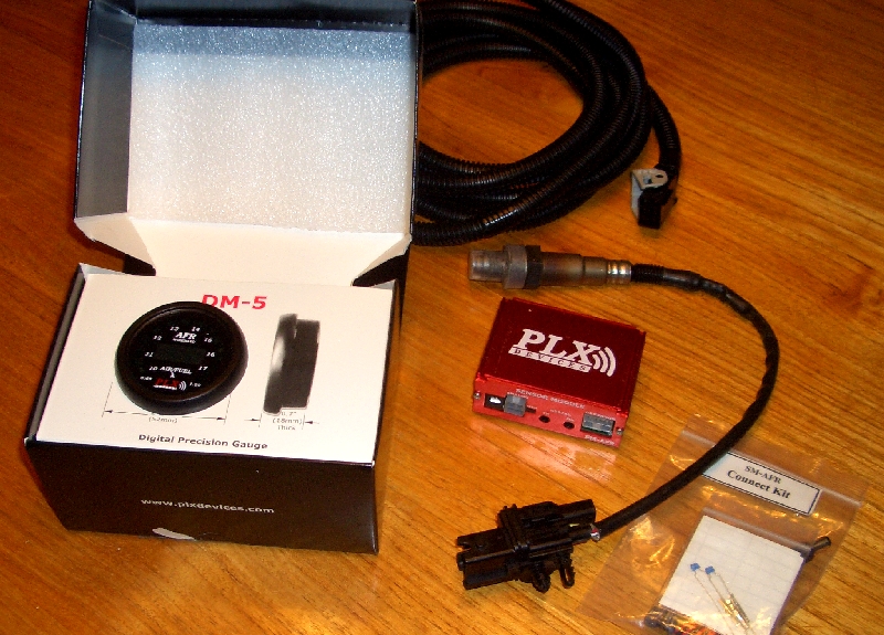

I've set aside trying to make diaphrams for now. Since they're available in rebuilds from Bosch (albeit at big $$), or can be harvested from 1.7 MPS's for a bit less, the common problem now seems to be how to tune the MPS to a specific engine. Whether it's a new MPS, a good used one, or a rebuild, factory settings are at best a compromise. Our engines are old and worn, or rebuilt with tweaks from original. Even a newly blueprinted engine should have it's MPS checked, because even original factory settings were a compromise in the first place.
I had a scheme where I would use a Type 3 MPS (no diaphram, only aneroid cells) as a slave, and measure vacuum level that resulted in desired AFR. This could then be translated into inductance to plot desired MPS curve. I think it would have worked, but it would have been very awkward. Then I hit on this idea.... We'll see. ![]() |
