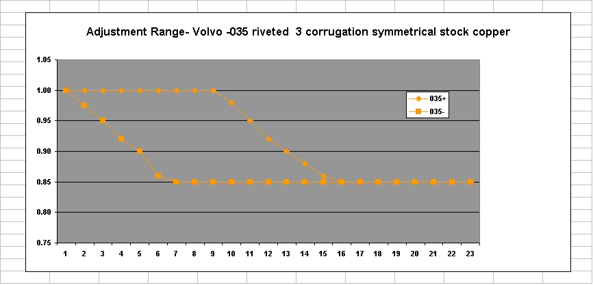

jk76.914   Quick update. I did the crappy brass characteriza...   Feb 11 2010, 04:59 AM

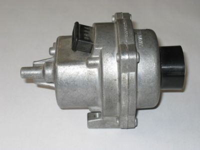

jk76.914   Picked up a -010 MPS this week, allegedly from a V...   Feb 27 2010, 04:57 PM
ArtechnikA   The diaphram hub is idential to stock, which I...   Feb 28 2010, 05:16 AM

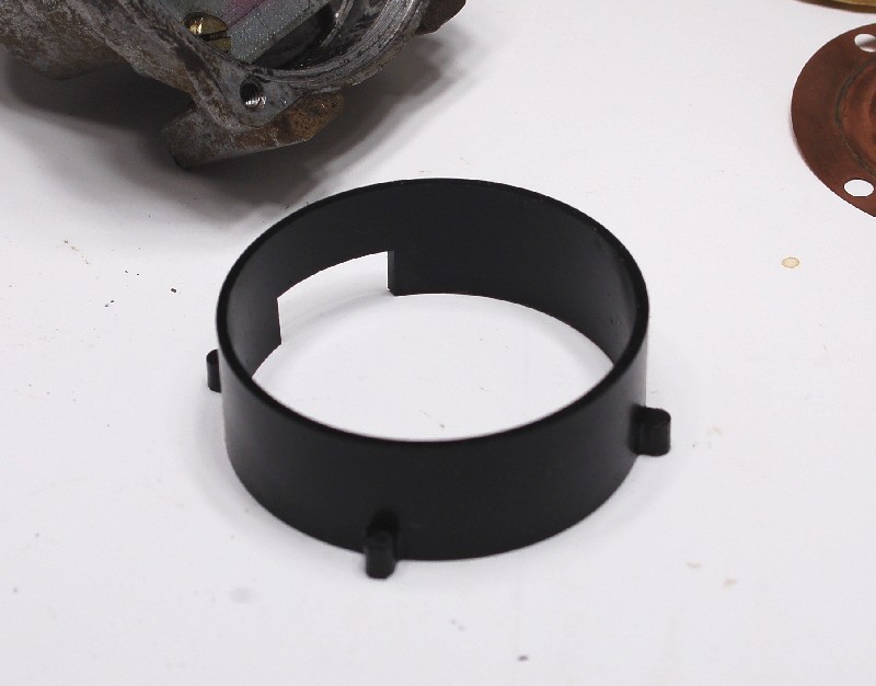

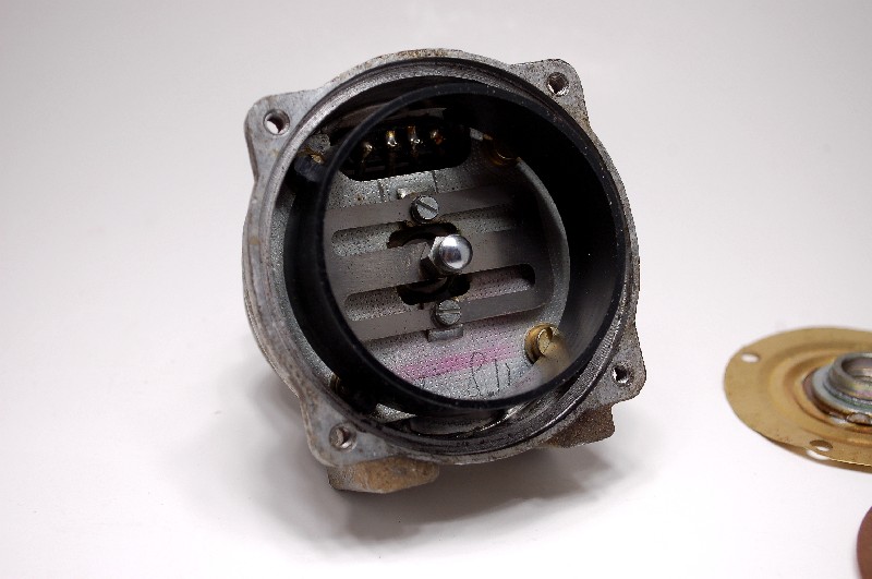

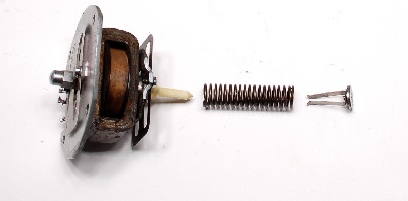

jk76.914   OK, some images from that -010 Volvo MPS. First t...   Mar 1 2010, 06:45 PM
jk76.914   Nice clean housing. Not perfect, but not bad. Yo...   Mar 1 2010, 07:09 PM

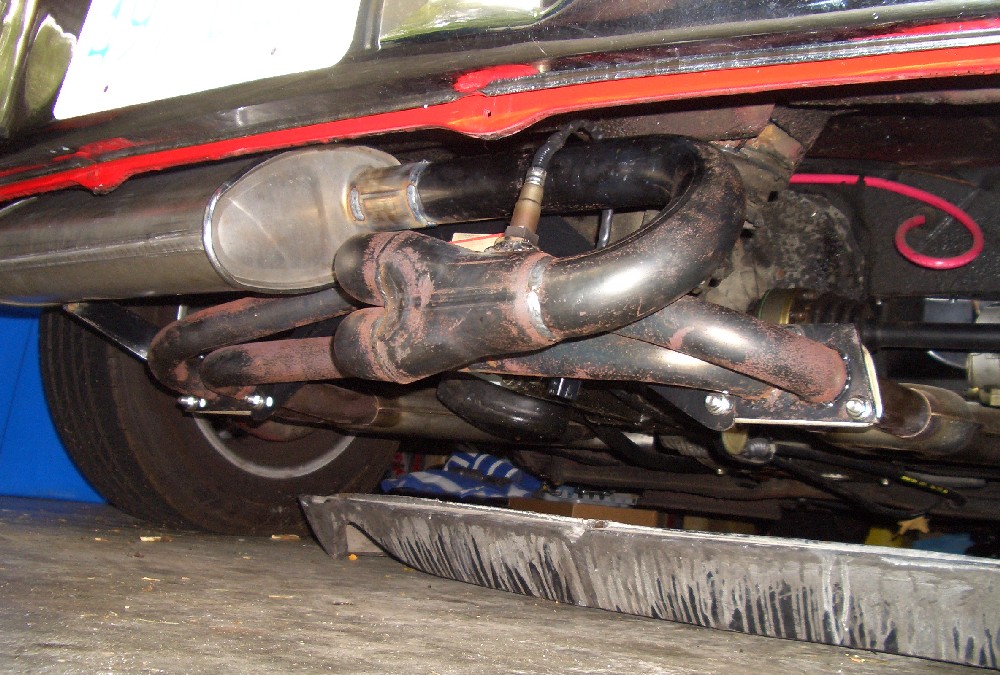

Larouex   [quote name='Bleyseng' post='1282691' date='Mar 5...   Mar 8 2010, 09:29 AM
Bleyseng   [quote name='Bleyseng' post='1282691' date='Mar ...   Mar 8 2010, 10:52 AM
pbanders   First you weld a "bung" onto the exhaus...   Mar 8 2010, 11:05 AM

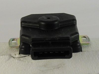

jk76.914   Well, I guess it's time to get back at this. ...   Dec 6 2010, 07:04 PM
jk76.914   I've set aside trying to make diaphrams for no...   Dec 6 2010, 07:14 PM

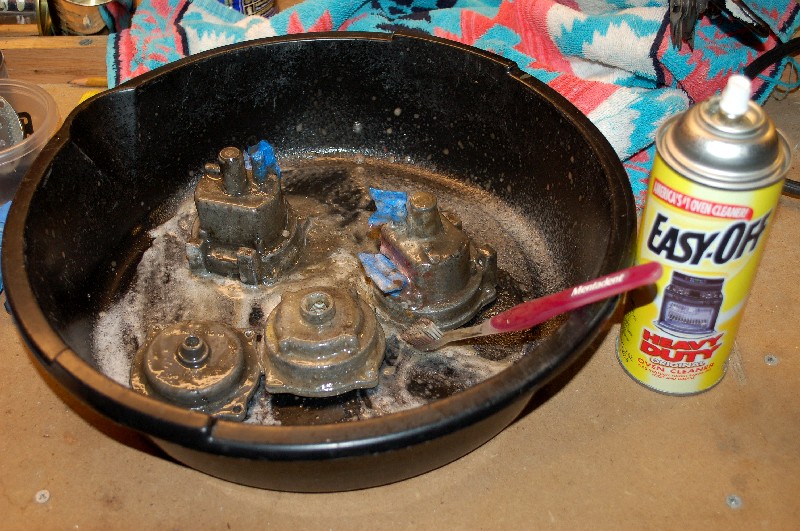

jk76.914   Here's a loose end from last spring. I dissec...   Dec 6 2010, 07:29 PM
Bleyseng   Here's a loose end from last spring. I disse...   Dec 7 2010, 06:35 AM
jk76.914   I know. Something had to give. If I focus on mak...   Dec 7 2010, 07:22 AM
