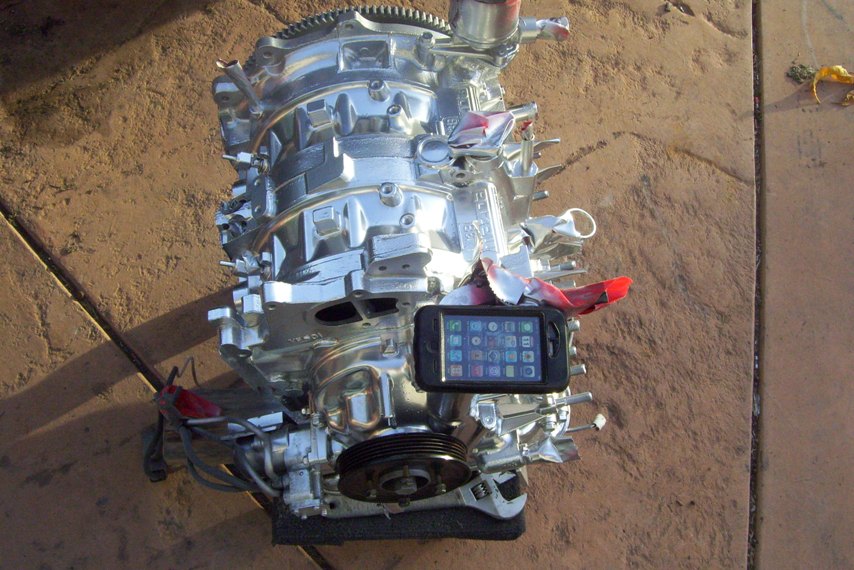

Not much to update. I've been collecting parts. Here's a pic of the cleaned and painted engine. I put my Iphone in the pic to give an idea of just how small these engines are. Picture a type 4 without heads and cylinders. This little turbo engine will make 350hp at 15 psi with 250 ft lbs @ 4k
GT35R Ball bearing Turbo- oil and water cooled
HKS cast iron exhaust manifold
Haltech ECU
HKS Blow off Valve
HKS wastgate
HKS Boost controller
2000cc injectors (x4)
Areomotive fuel regulator
Custom Rails
4" exhaust
Aero Turbine Muffler
Frozen Boost air to water intercooler
Damn this conversion is getting expensive!
