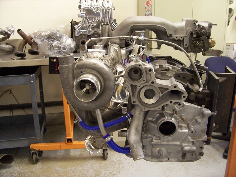

GT35R Ball bearing Turbo- oil and water cooled
HKS cast iron exhaust manifold
Haltech ECU
HKS Blow off Valve
HKS wastgate
HKS Boost controller
2000cc injectors (x4)
Areomotive fuel regulator
Custom Rails
4" exhaust
Aero Turbine Muffler
Frozen Boost air to water intercooler
So are you switching to single turbo with the ball bearing unit?

Yes, Single. with new manifold. The stock twin turbos are nice in stock configuration but the single is far less complicated and will yeild more power. The turbo I'm using can get me up to 450-500hp @ 25+psi but I want the engine to remain reliable hence the 17psi max plan.
It will look similar to this one...
