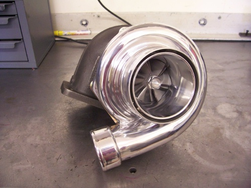

kg6dxn   This pic is for Andrew. It shows the chosen turbo ...   Dec 13 2010, 07:11 PM
Andyrew   Not bad, A little low for the turbo size, but stil...   Dec 14 2010, 10:37 AM

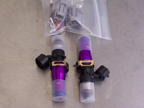

kg6dxn   Whats next? Injectors 4@ $180 each, 2-850cc...   Mar 22 2011, 09:27 AM
Andyrew   Ouch! The little stuff just adds right up..   Mar 22 2011, 09:39 AM
trojanhorsepower   Injectors 4@ $180 each, 2-850cc, 2-1600cc Fu...   Mar 22 2011, 06:15 PM
Lennies914   Injectors 4@ $180 each, 2-850cc, 2-1600cc F...   Mar 22 2011, 08:58 PM
