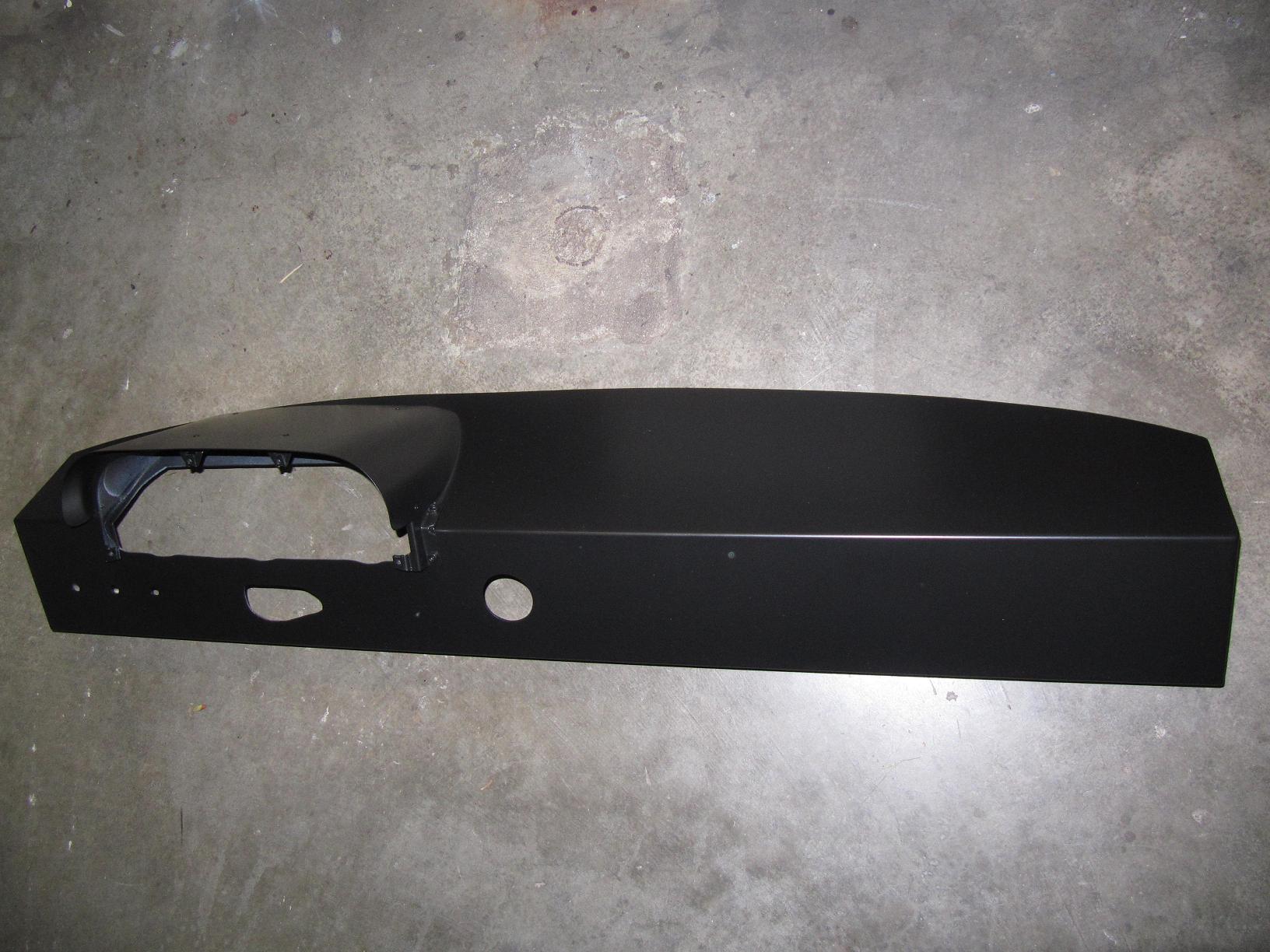

Dash pic added. Wrinkle finished failed large flat surface area. My Webpage Painted SEM Tirm Black.
