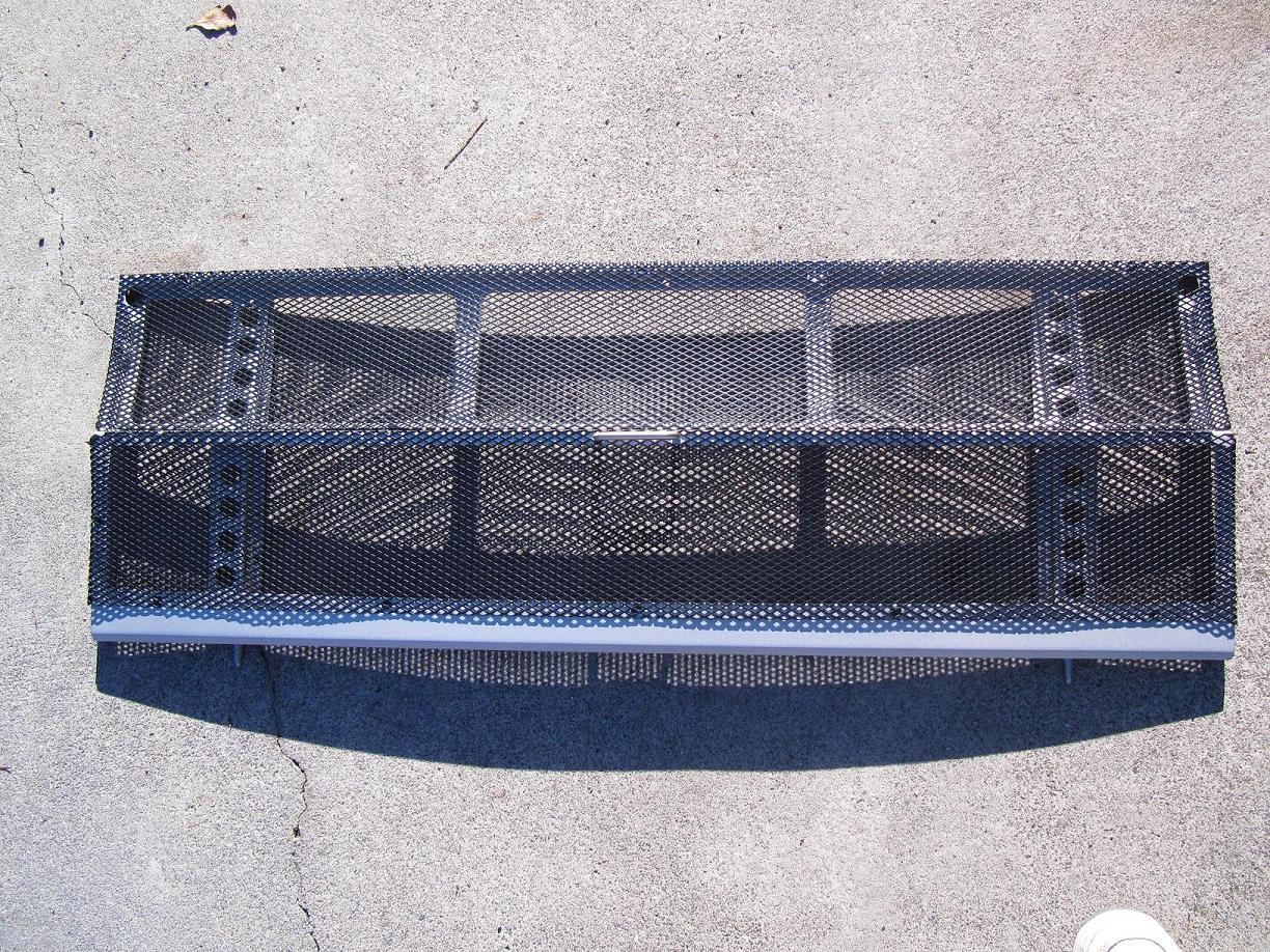

Got the engine lid finished. Home depot handle and pins to locate on the fire wall. Hood pins will hold it on to body

Krieger   Got the engine lid finished. Home depot handle an...   Dec 12 2010, 11:22 PM
