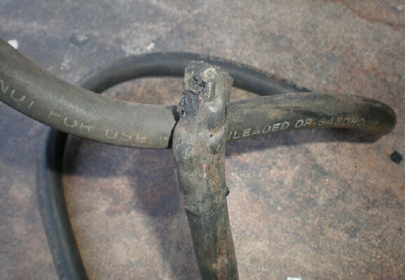

I posted this pic a while back, but here's an example of a PO using the wrong type fuel hose.
Paul

QUOTE(AvalonFal @ Dec 12 2010, 09:01 AM) *
Paul
yikes!!! never seen it that bad before!!!!
could this hose possibly been exposed to batery acid?

Here's another pic. Notice the printing on the hose
"Not for use with unleaded or gasohol fuels."
It was one of the under the fuel tank lines.
Paul
