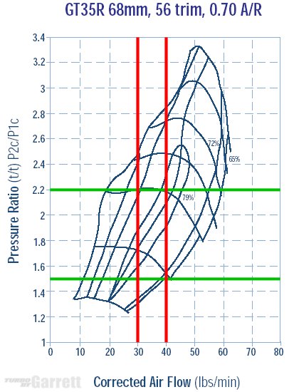

This pic is for Andrew. It shows the chosen turbo (GT35R) and the performance window the enigine is tuned towards.

Andyrew   Is that an HTA compressor side? If so, SWEET!...   Dec 13 2010, 12:07 AM
kg6dxn   This pic is for Andrew. It shows the chosen turbo ...   Dec 13 2010, 07:11 PM
Andyrew   Not bad, A little low for the turbo size, but stil...   Dec 14 2010, 10:37 AM
